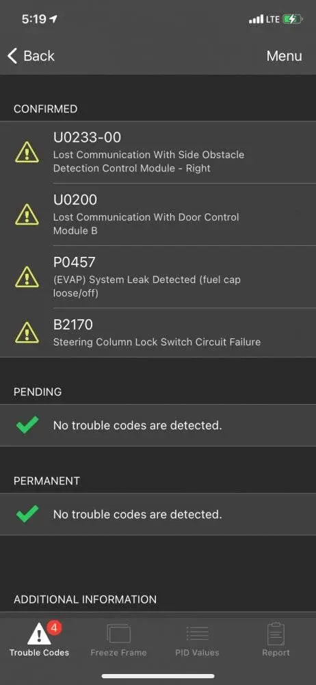

Hard to say. Scan for codes, and if there are any, then there is a good chance it is the "keyless control module".
Here is what mine currently shows (U0200 & B2170).....
