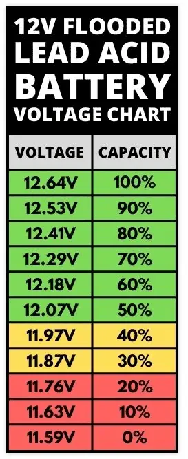

Typically, 12V batteries have a "resting voltage" (fully charged with car off) ~12.6 V and when the engine is running (without issues), it'll rise to somewhere in the 13.5 to 14.5 V.
The battery needs at least ~13 V to charge.
A lead acid nominal 12 volt battery is 100% charged at 12.6 volts. As said above charging voltage to force power into the cells is in the high-13 to mid-14 volt range. The noted 13.5 to 13.8 volts is good. I don't know where the alternator indicator is connected, as said above, you might look for loose or dirty connections.
