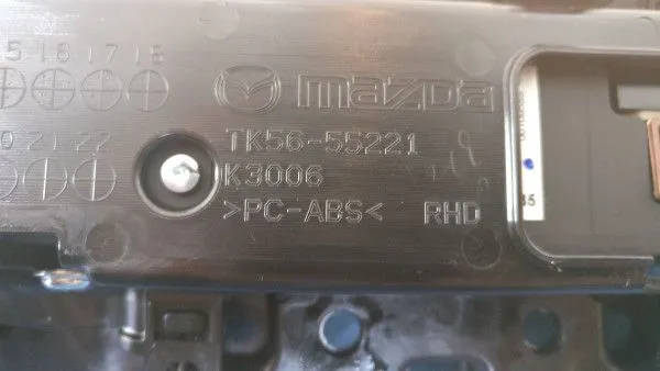

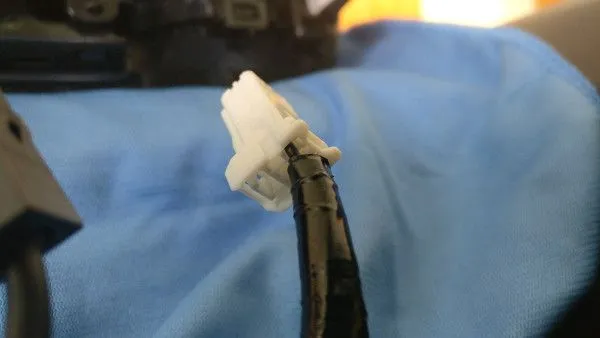

I am trying to install AIO tweaks on my CX-9 year 2018. After I open the unit, I found out that the connector is different from the other models unit. Can anyone point me out where can I find the wiring diagram of the unit? I want to know which pin is Tx and Rx. Here are the photos of the unit.
Thank you in advance.

It looks like the 0920-301B connector shown in both "AudioSystem 3a.pdf" and "AudioSystem 3h.pdf" matches the PIN layout shown at https://mazdatweaks.com/serial/. The top post of this thread looks like it's showing the connectors for the display, as 0920-304A and 0920-304B in "AudioSystem 3a.pdf" match "pic3.jpg" in this post, rather than the CMU, which you can apparently after removing the display. So cottonee maybe you need to remove the CMU next...? Has someone tried pulling the CMU out to see if we actually have the 0920-301B connector, or is that what people are waiting for? It seems like if we have this connector, we should be able to do the serial tweaks.
