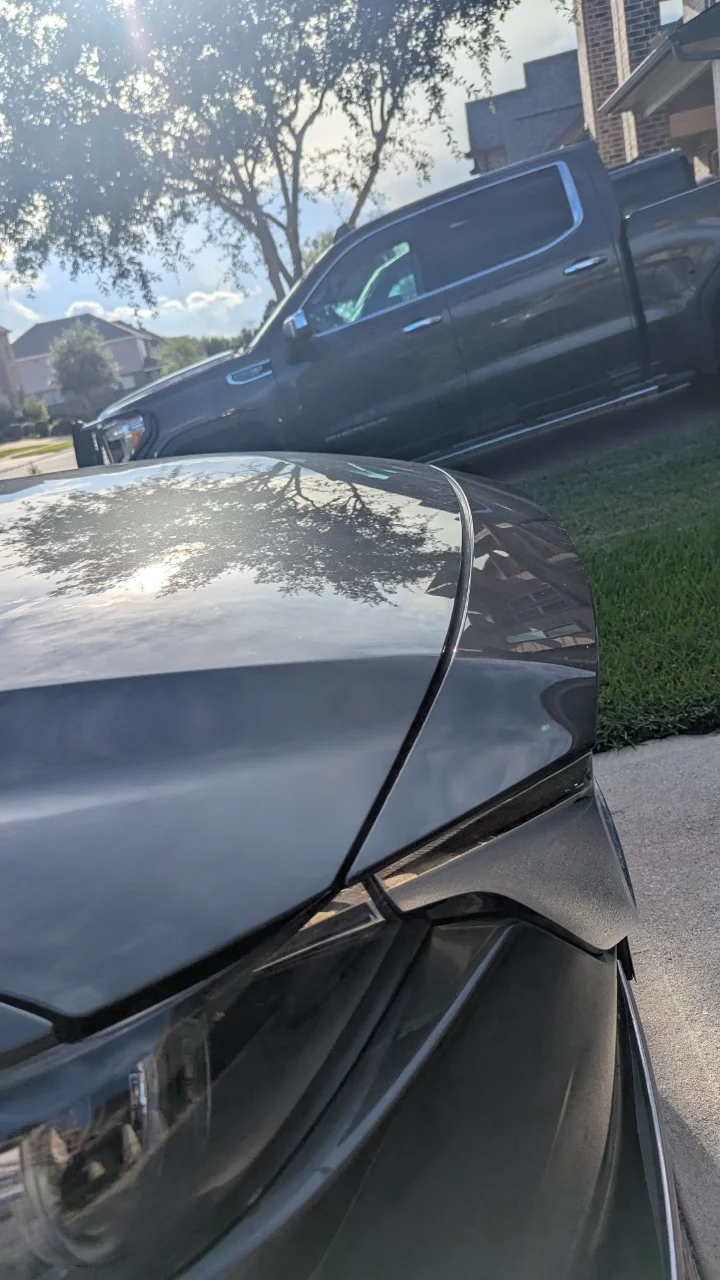

Can someone send a picture of their hood and the front panel? I was in an accident and I recall the gap being that big between the hood and front panel. TIA
The vehicle is still being worked on. I did an initial inspection and I think the hood alignment is off. I don’t have proof which is why I was asking anyone to send a picture of theirs.
Hope this pic helps

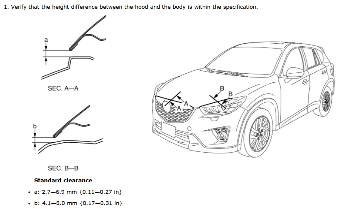

Sure, though that post of spec measurements was for the CX-5. Of the numerous CX-5, CX-9 and modern CX's I've seen, on the street the gaps are visually all roughly similar to that of my own CX-5. (I've paid attention to them, since my hood and lift gate alignment is somewhat off "even", though it's within the technical spec.)
Uncertain what the CX-9 workshop manual indicates, but I can't imagine it's that much different.

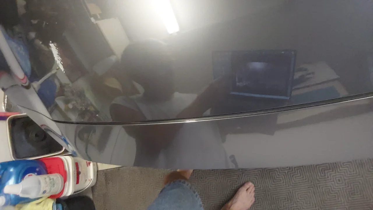

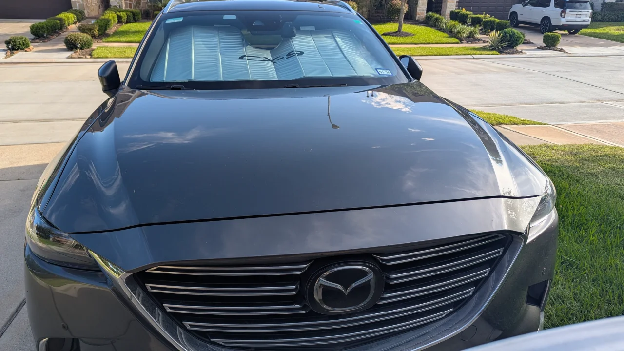

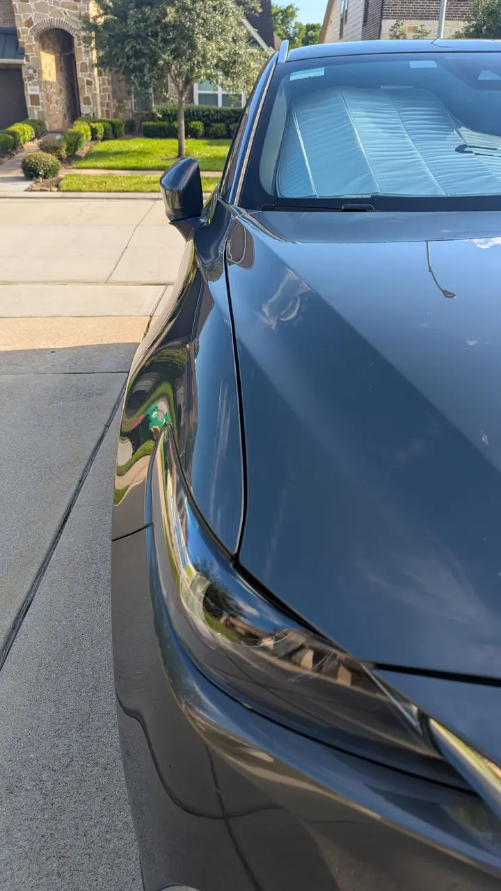

see attached
