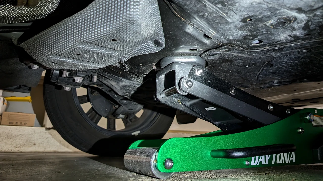

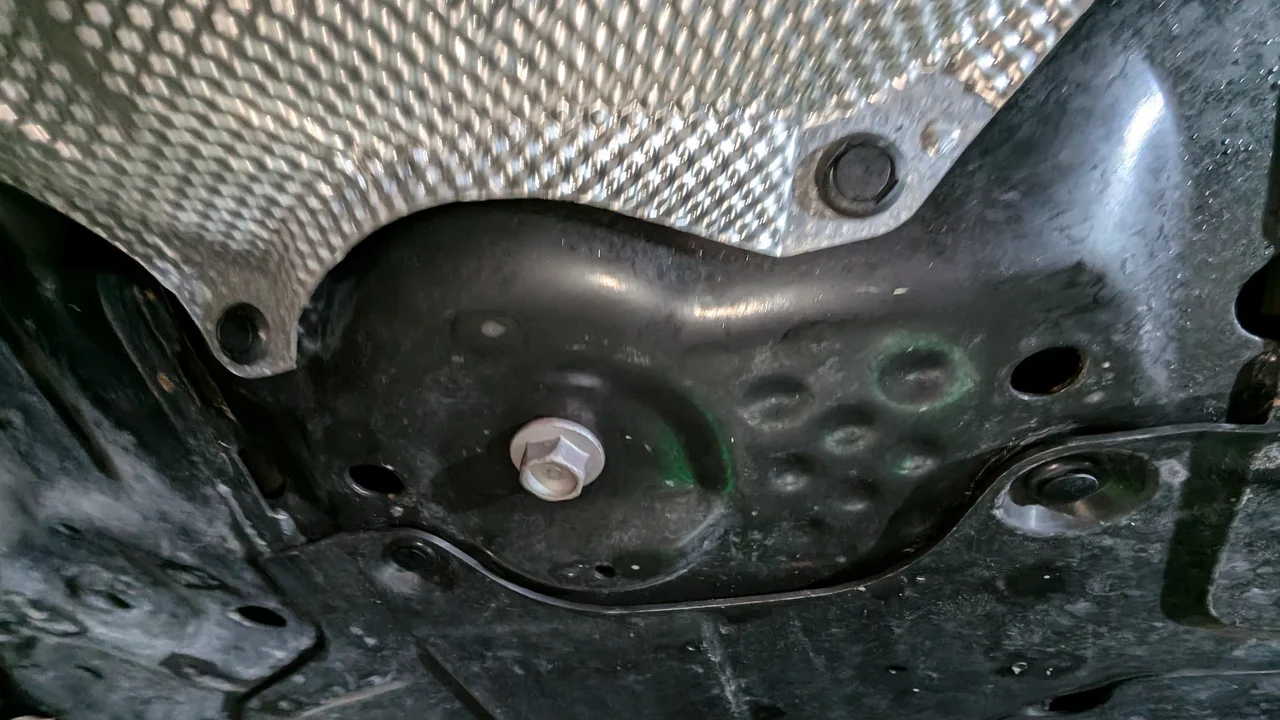

2. Put a jack under the engine or suitably support it then remove the after bolt on the torque strut.
I hope you didn't actually mean the engine! For everyone else's information, the car should only be supported on the crossmember with the dimple pattern on it:
Otherwise, great write-up. Labor intensive indeed.
I did mean put a jack under the engine. I used a bottle jack and a piece of wood. The reason being is that you are removing the bolt from the torque strut or the after motor mount. What you are doing is trying to make sure the engine and transmission do not rotate about the horizontal axis. There should be very little force on the jack. Your engine is supported on the left and right sides. One is called the motor mount and the other the transmission mount. The torque strut is the 3rd motor mount that soaks up rotational torque due to the transverse mounting. You are merely preventing the motor from rotating and over stressing the motor and transmission mounts. I removed the jack and used a prybar to rotate the engine and align the bolt holes when re-assembling.
I would not have guessed that. Thanks for explaining. But there has to be a better way.
