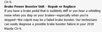

Just got a 2018 CX-9 Touring with 44000 miles on it and break pedal makes hissing or swishing noise in drivers side footwell when depressed. It is coming from brake booster. Also brake pads sometimes click going from reverse to forward. Is my brake booster failing or is this a normal thing for these cars or is it something else?

This is from the Mazda parts site:
They want $510...you can find a better price. Rock Auto doesn't have the Cardone reman booster in stock.
