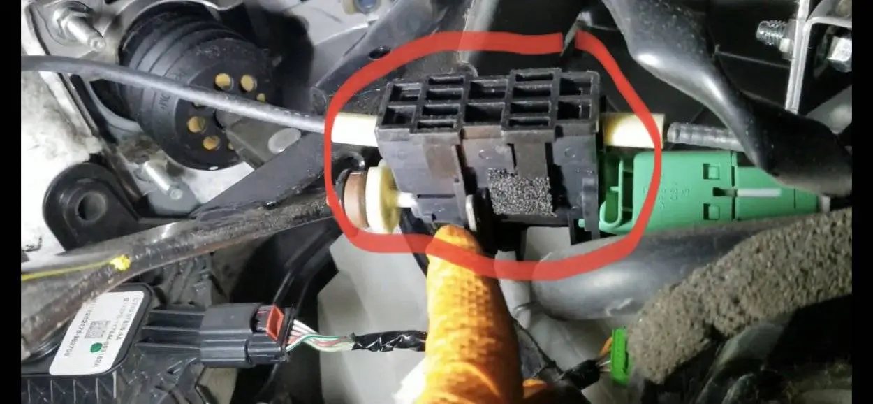

Hello everyone, I did not want to open another title and decided to continue here.
I replaced the brake booster on 2011 CX-9. It took a long time to remove it out and install the new one. I filled the reservoir and bled the air. Brake works fine. I adjusted the brake switch also.
I do not know what is the part name between pedal to brake switch. It is black box. When I open it, a white plastic part with spring came out. I tried to reinstall it but all I had some issues. I attempted to install it, I couldn't turn off the ignition. Tried a different way, gear knob moved without brake pedal. One time it worked fine but it locked the gear knob.
I removed it now and it works fine.
What is this part called? Any idea how I can install the white plastic part in it? Plastic part is held on with a cable and it makes something in the box. No white plastic showing in picture.
