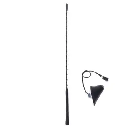

The easy solution for whistling crossbars is to wrap a cord in spiral fashion across the bar. Think like on old antennas:
