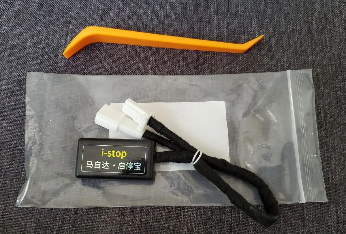

What you get in the box (although the yellow pry tool is totally unnecessary):

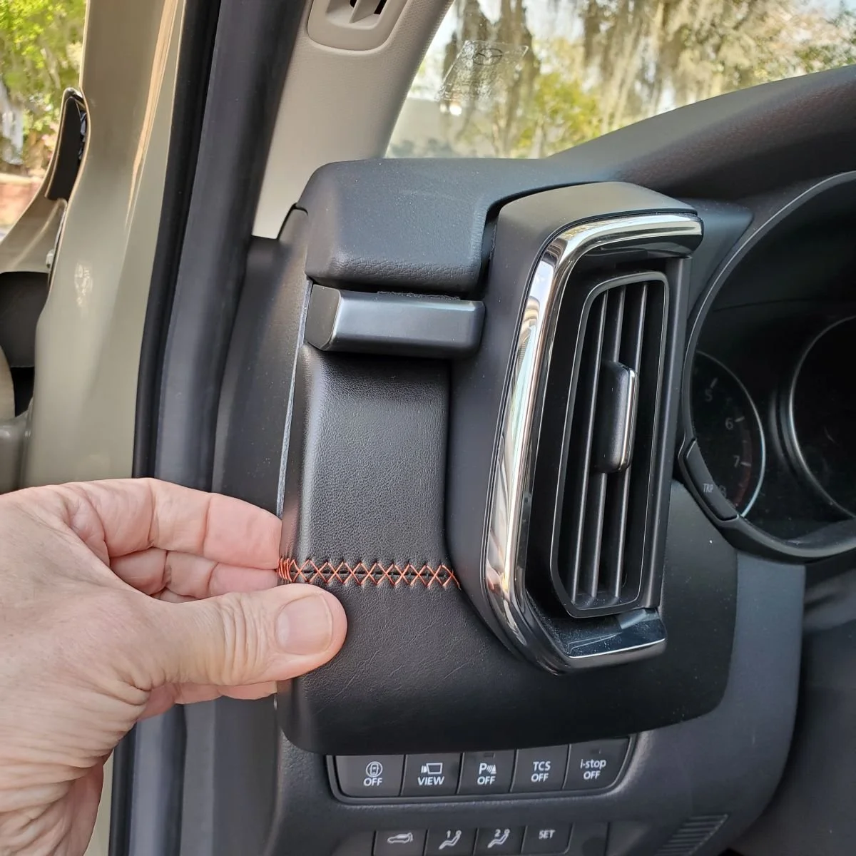

There are no instructions with it, but again, installation was very easy. First you need to pull off the driver air vent unit. Just get 8 fingertips (4 shown here as I was taking the photo
) into the side join where the leather wraps back inside the dash, and PULL. The vent and surround will unclip:

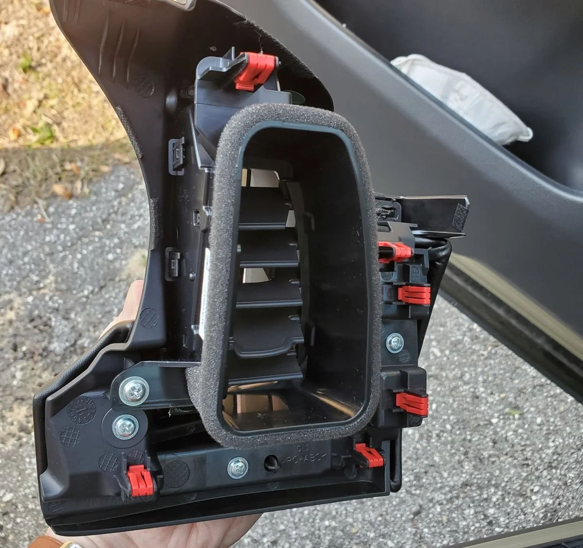

This is a view of the back of the vent, so you can see where the (red) clips are (again just FYI):

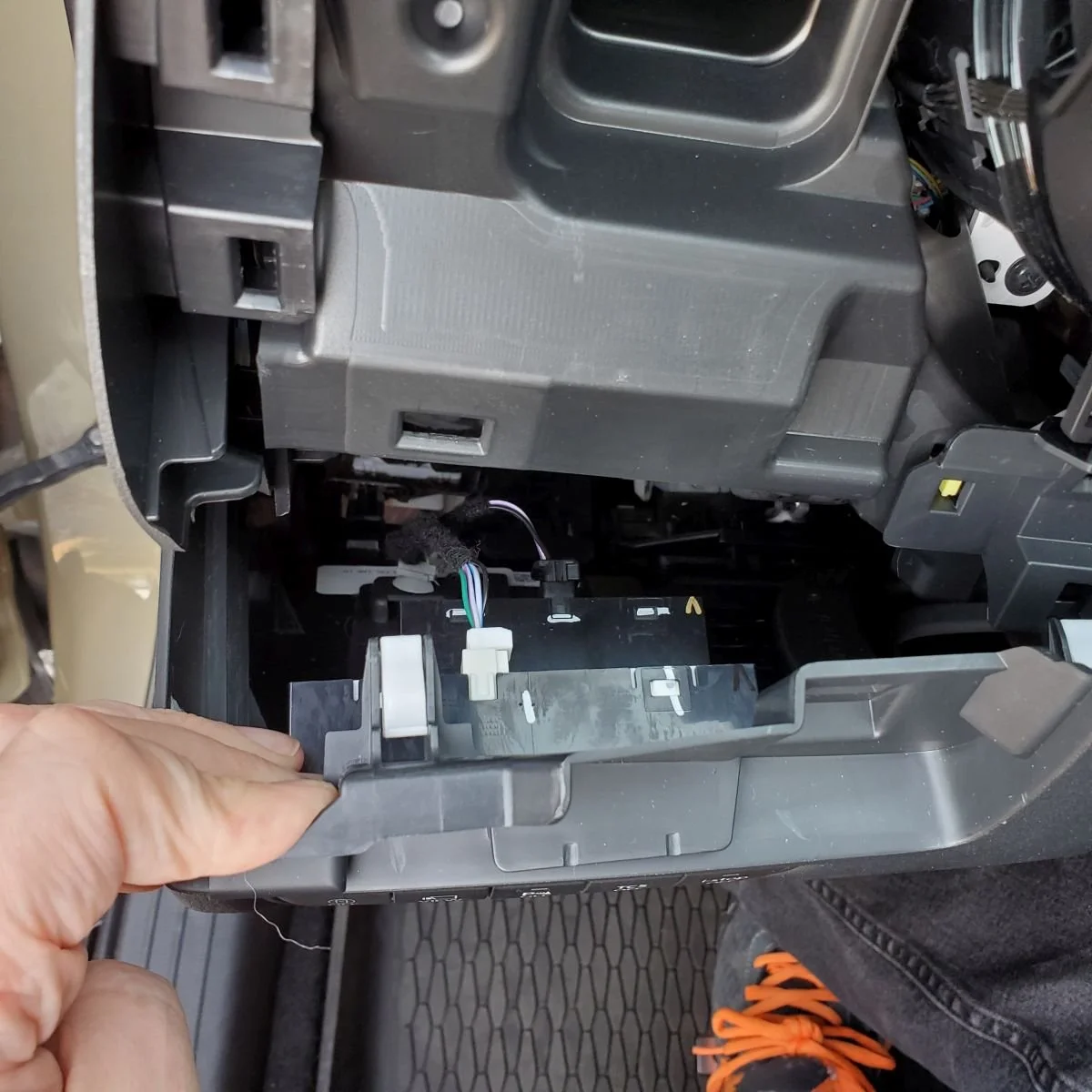

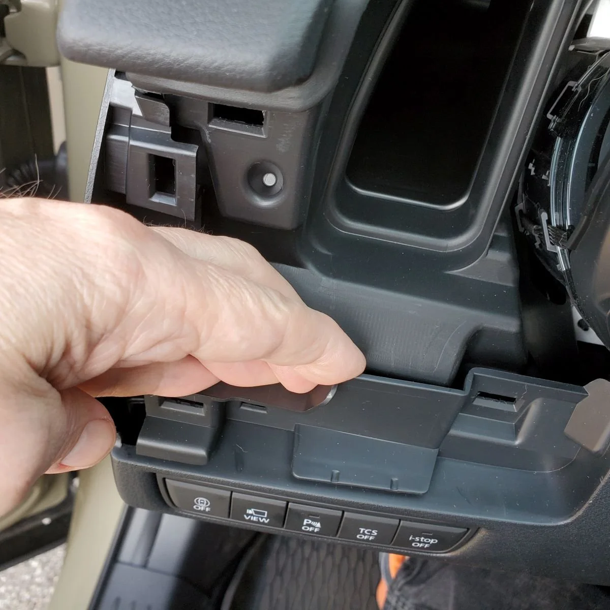

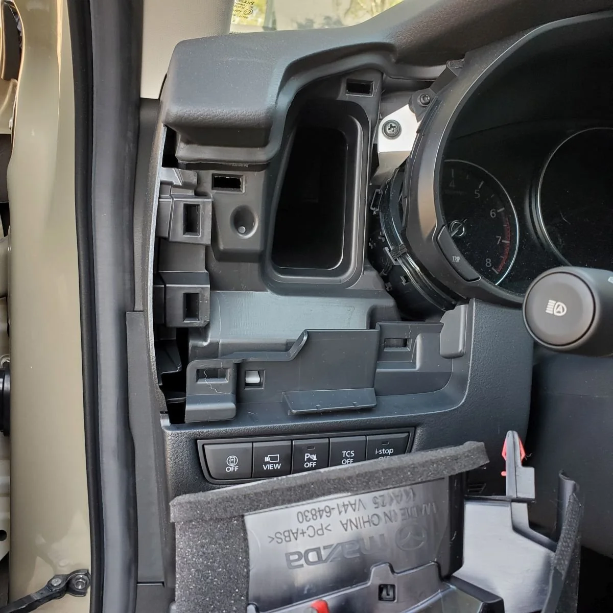

Then pull at the inside top of the lower dash and unclip the top clips and pull back enough to get access (you will NOT remove the whole unit here, just bend it back a little). You should see the top white connector into the button box:

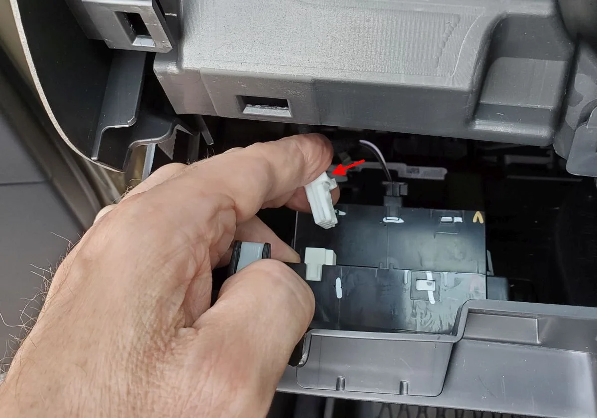

Now get your fingernail in to press-in the connector 'catch' on the steering-wheel side of the plug (arrow) and pull the plug out. You may find getting the catch pushed in is a little fiddly, but persevere:

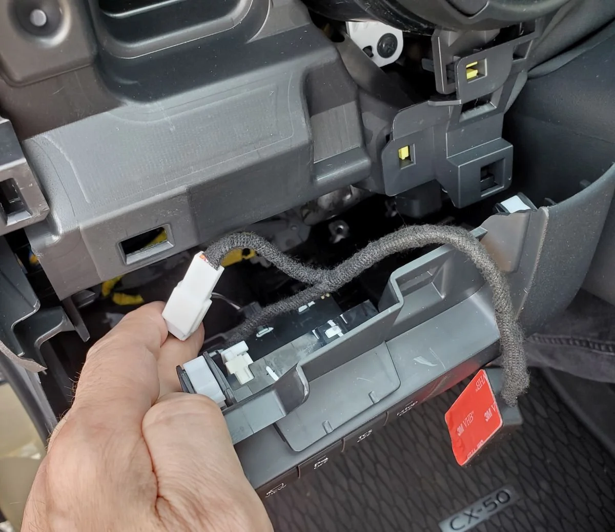

Then plug the cable into the socket on the pigtail from the iStop disable unit, and the pigtail plug-end back into the button box:
Then you can peel off the backing of the sticky tape and stick the box against a flat area inside the dash to stop it rattling around (no pic). Push everything back together and you're done!
