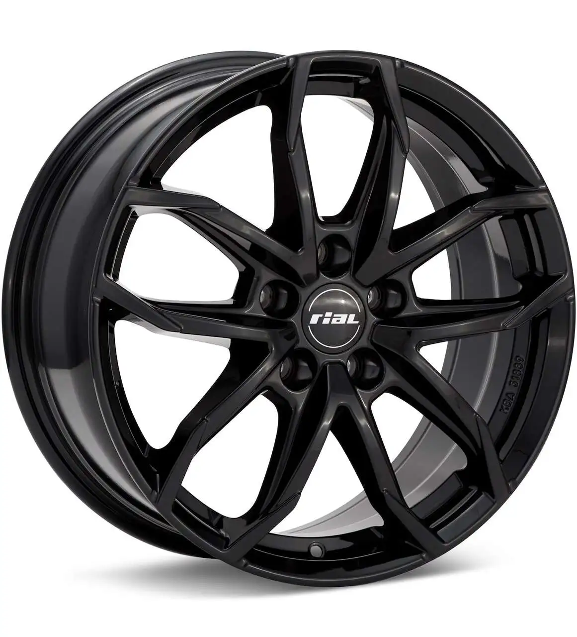

I got a nice set of Rial alloy rims with Michelin X-Ice tires from Discount Tire a couple of years ago. The tires were mounted on the rims, balanced and shipped to my home. Total cost was about $1500 including TPMS sensors.
