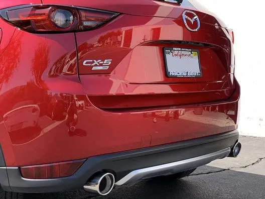

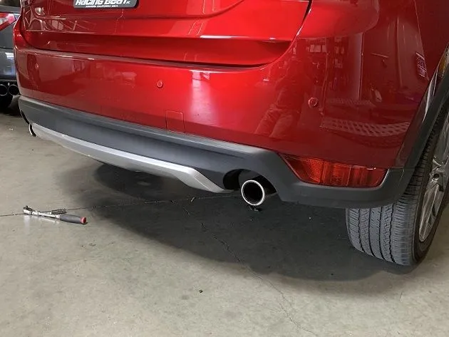

I brought my 2019 CX-5 Signature in to have the existing RB (non-turbo) muffler test fitted.
What we found was:
The OEM turbo muffler is about the same weight and size as the RB (non-turbo) muffler. - (both are about 10 lbs lighter and smaller than the OEM non-turbo muffler)
A test with a decibel meter showed no audible difference between the existing RB muffler and OEM turbo muffler. (the turbo quiets down the exhaust significantly)
and the tips stick out a little too far.
Racing Beat is developing a new turbo muffler version based on testing done that day and will contact me when the new one is ready for testing.

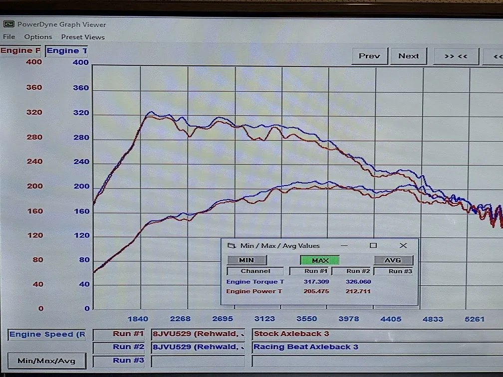

I plan on dynoing before and after (with no tuning at this time).

We made several dyno pulls and as expected; the ecu adjusts for the new component after the initial pull and the power drops... but not all the way!
Power gains are around +7 horsepower and +9 torque after everything levels out.
The sound is very slightly increased from stock, as I would expect a luxury car to sound. At first I thought it might be too quiet, but after driving it around a while I think its actually perfect. I will try my best to describe it in leu of a video:
Instead of it getting louder, I would say the noise you hear from the engine is now met with equal sound from the rear when you get on it but when cruising you don't hear anything. Due to the better insulation on this chassis (over the previous) it is a slightly different story if you are outside the car; it has a nice mellow note that you can tell is tuned up a bit if you're a 'car person', but not enough to alert everyone in the vicinity to your presence.
Attached is the Dyno plot. This is a Mustang dyno - if you aren't familiar with dynos, the Mustang dynos read a bit low and Dynojet reads a bit high, but since we are comparing run against run on the same day and same dyno it doesn't really matter; the gains would be about the same. This is with 91 octane (I don't have 93 anywhere close by).
Nice, thanks for the follow up! The exhaust looks great btw, much nicer than the OEM tips.

I think 93 octane would put both gains in the teens easily.
