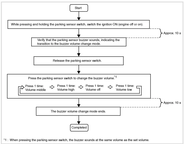

Same issue on my 2023 Homura. When listening to music and parking back I can't hear the sound of parking sensors. I'll email dealer and ask about that.
Upvote 0
Today I heard back from the dealer and they gave mi this instruction:
I'll test it later on but hopefully it will help :)
