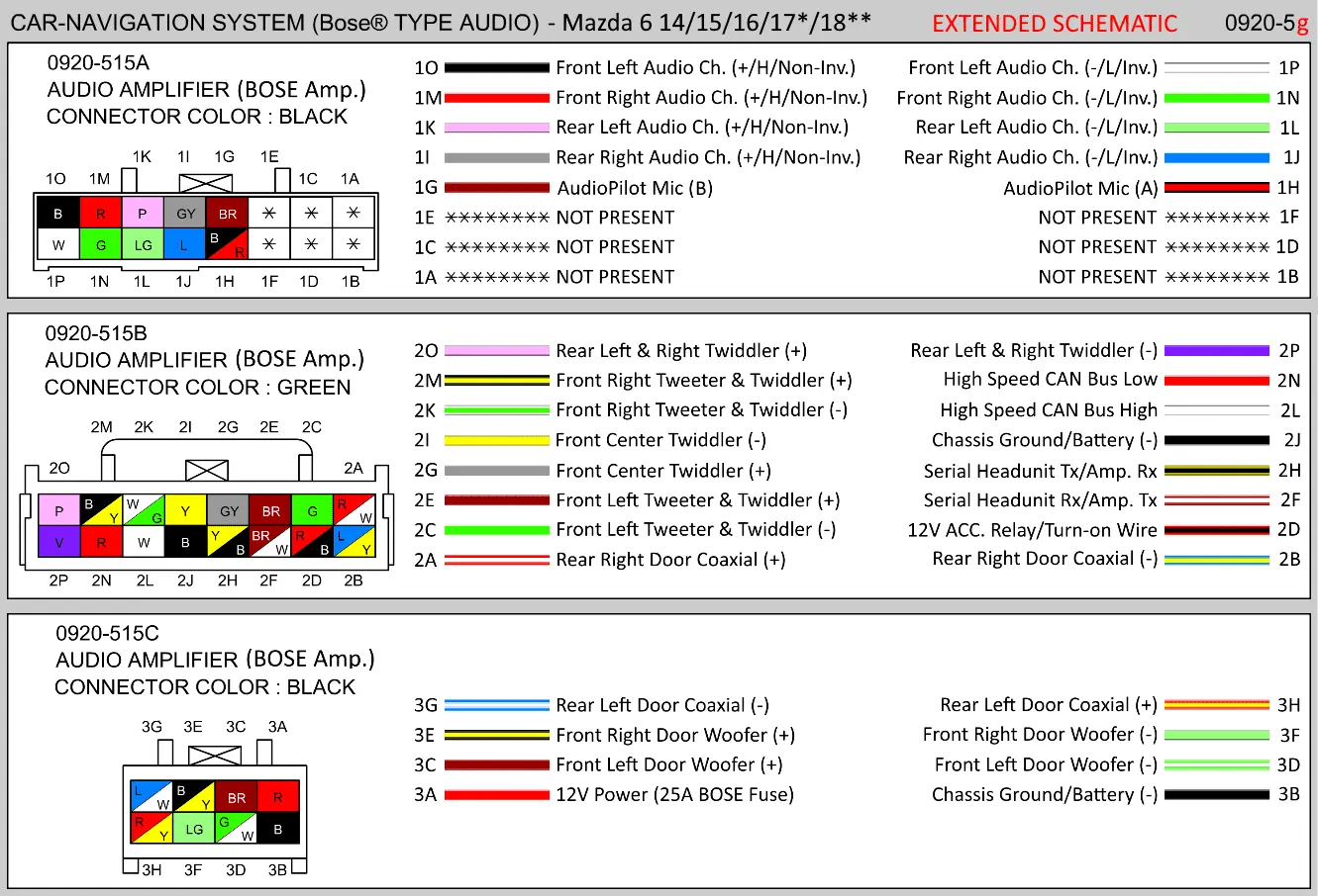

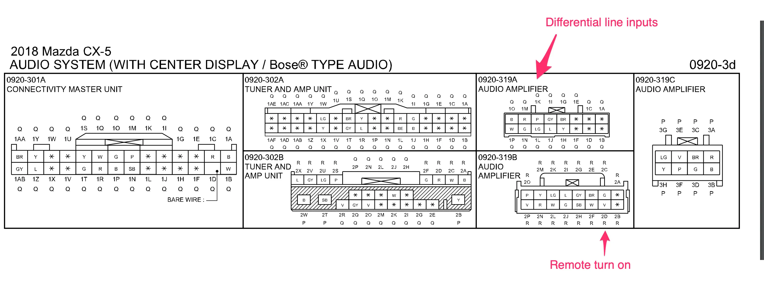

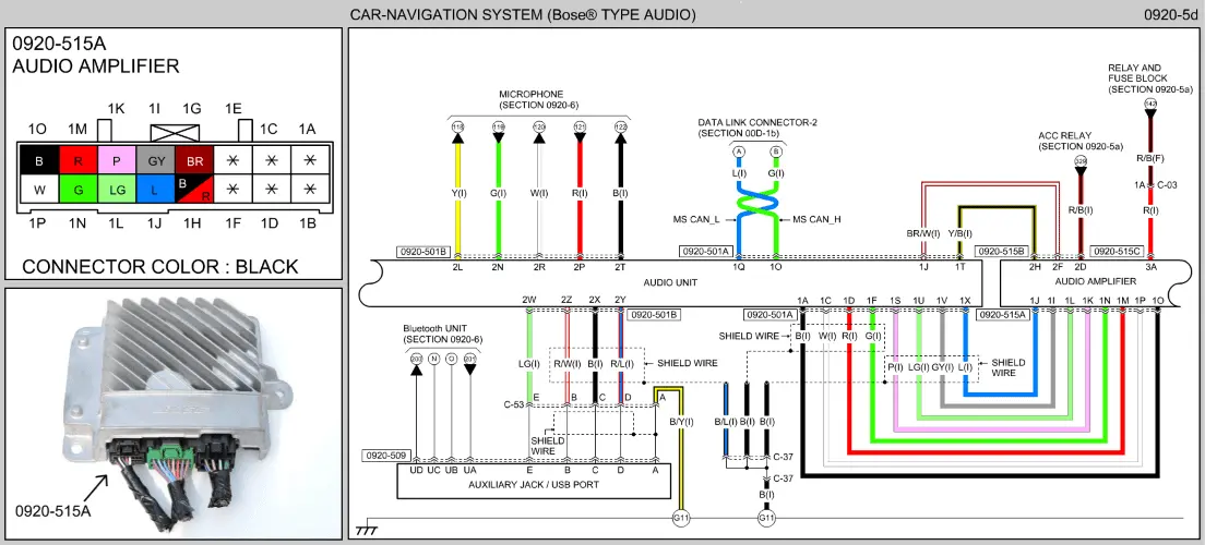

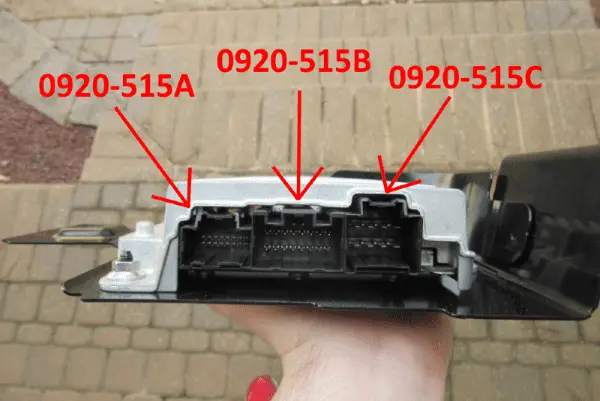

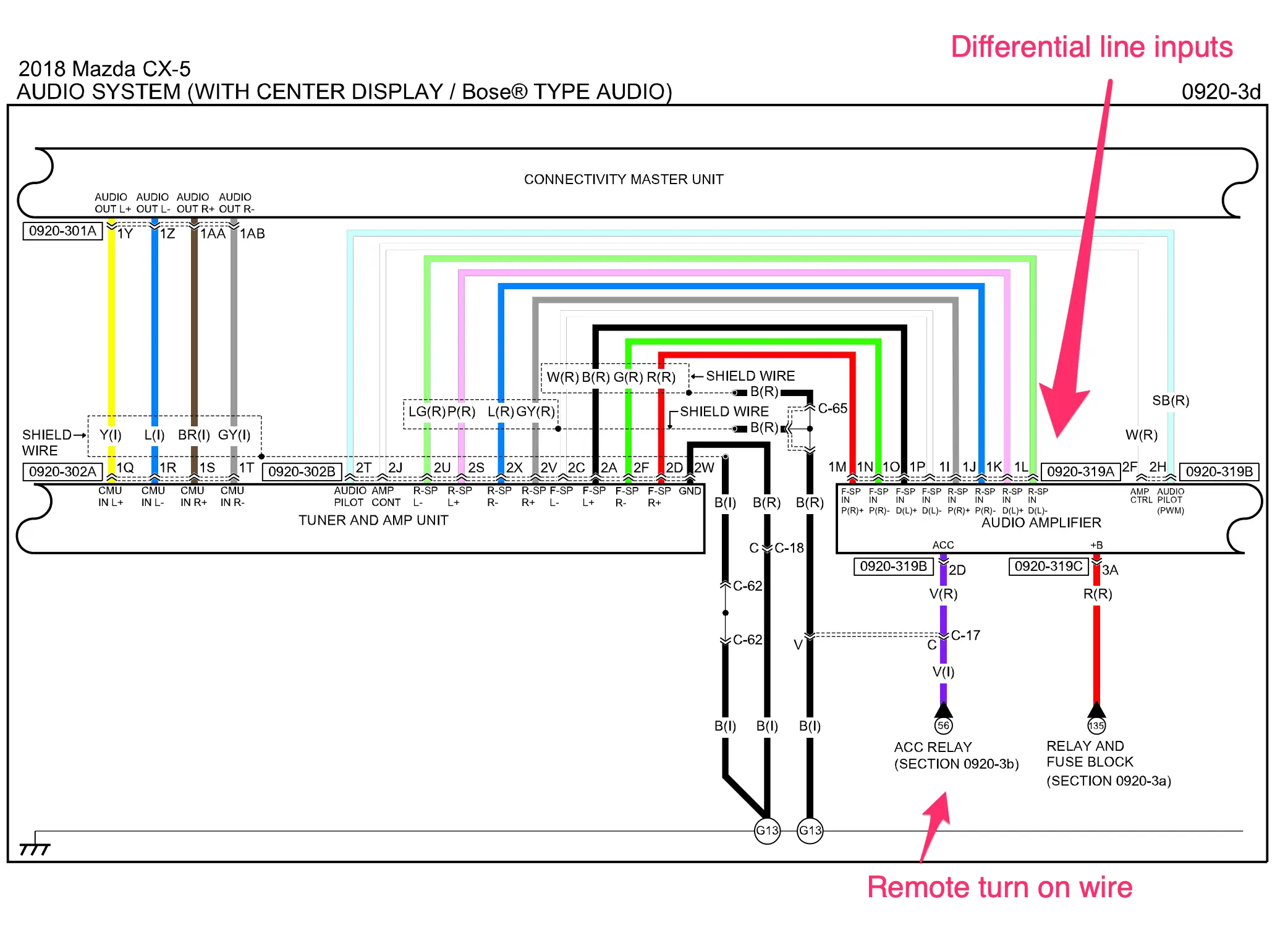

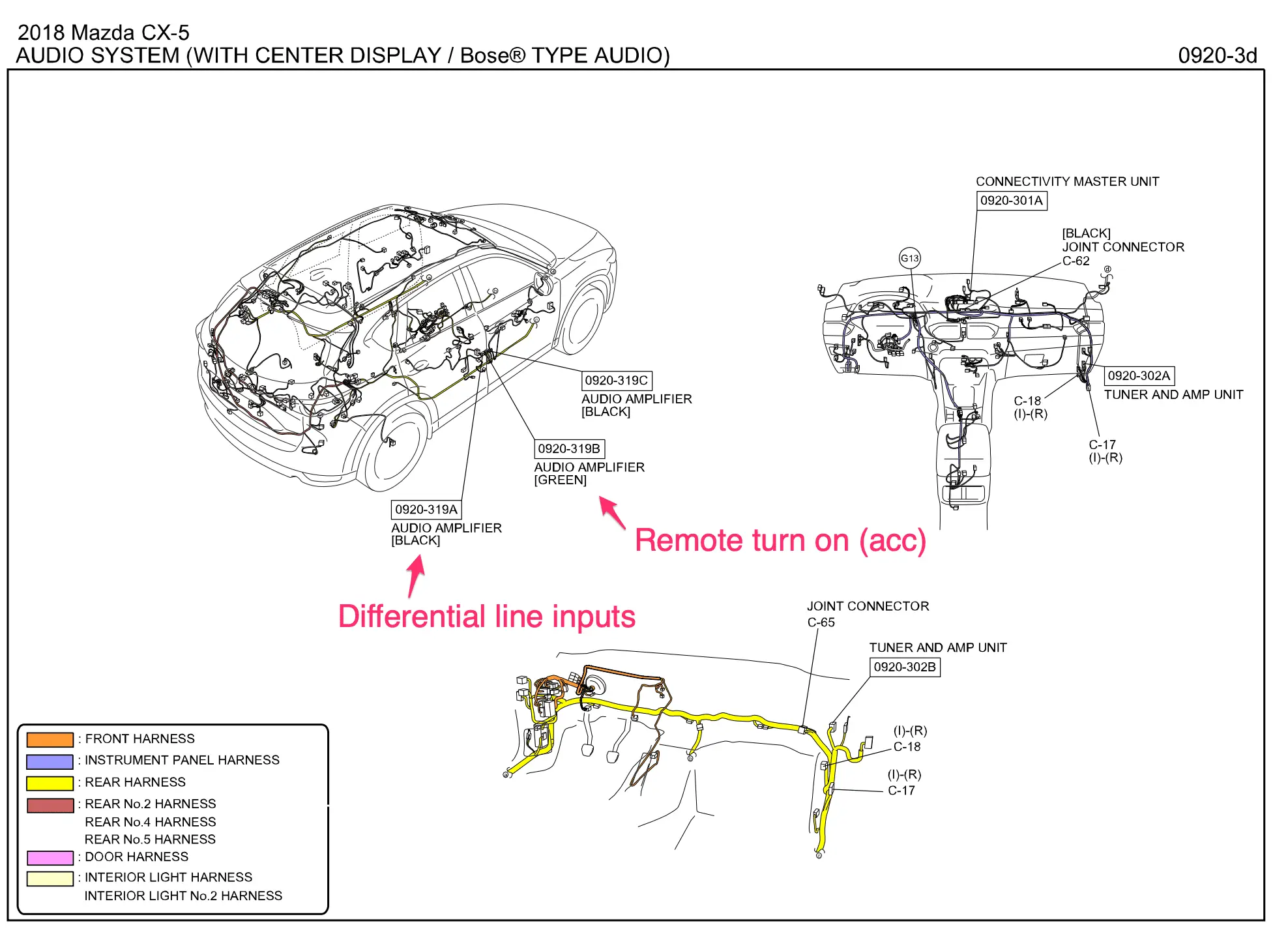

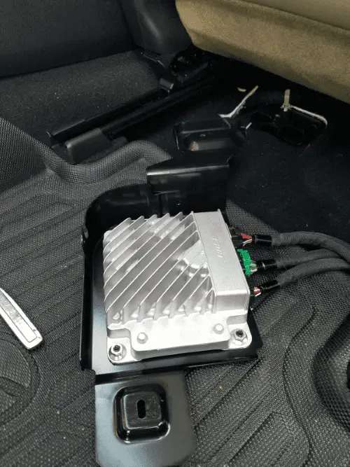

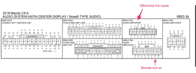

Found these 2018 CX-5 Bose wiring diagrams, and the cable color and pin locations match the results of the Mazda 6 Bose teardown thread that shows you get differential line-level inputs under the passenger seat going into the Bose amp and can completely remove the Bose amp if replacing with an aftermarket DSP or amp that accepts differential line-level inputs.
A followup on the teardown thread says:
Was in my car earlier and noticed that the volume actual caps at a somewhat random 63. This means that if the volume in that test was truly 40 that the output caps at 3.15V; honestly, I'd more likely believe that the volume when that shot was taken was a tad lower so that the actual max output is 3.3V.
The only difference I see between the Mazda 6 and CX-5 is the remote turn on (acc) wire is violet (CX-5) instead of red/black (Mazda 6), but both are in the 2D pin location on the middle connector plug on the Bose amp.
