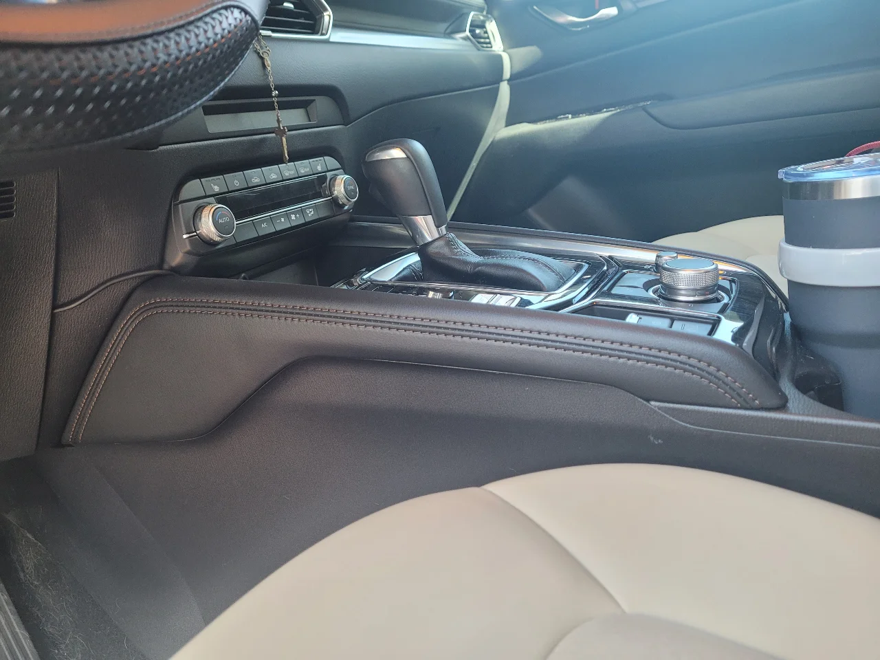

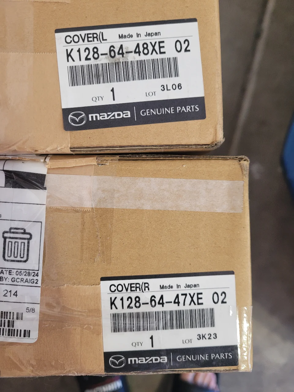

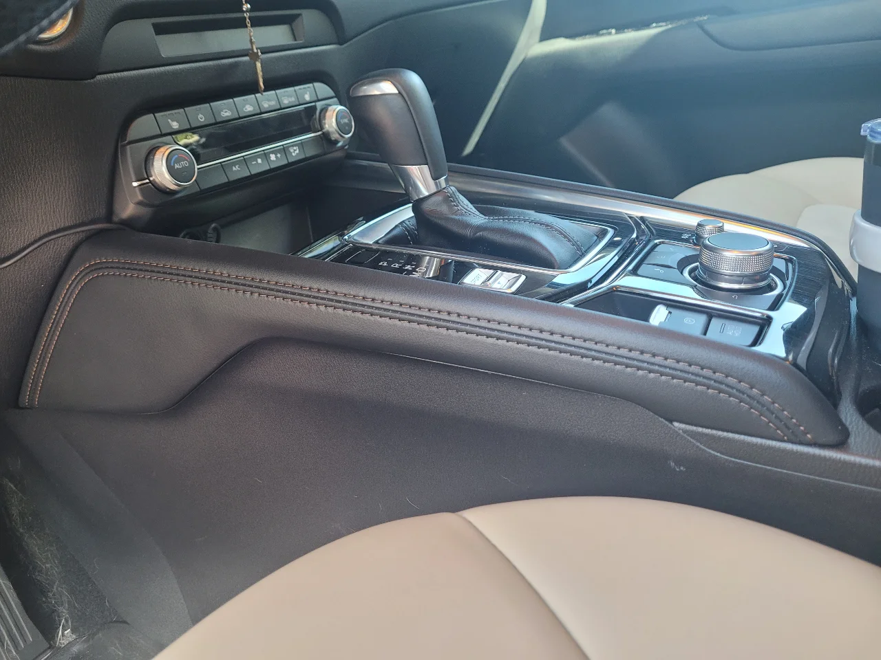

The lower trims have a black hard plastic trim piece so I bought these leatherette padded panels from the higher trim. They work great and no more sore knee while driving.
Seems like an odd place for mazda to cheap out. I've never had an issue with my knees being sore before the CX-5. Almost like the pedals are too far to the right, or the center console is too high or badly shaped.
Either way it was an easy install. Just grab the back closest to the cup holders and pull up. There's an inner and outer piece that comes off together. Don't try and take them off separate or the clips will break.
I think with shipping it was a tad over $200 for both drivers and passenger side.

Wow. Didn't know these existed - they look nice!
I have the same issue, but I just bought universal pads off Amazon. Cheap and work great, though not as factory looking, obviously.

Thanks!
I was considering that because it's way less expensive, but was worried they wouldn't stick very long in Phoenix summers.
