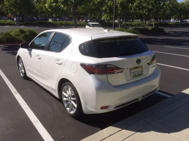

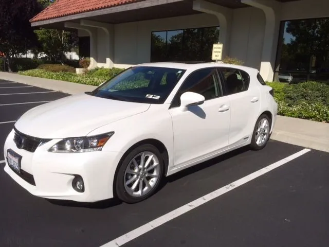

I think these Skyactiv gasser engines are the only non-hybrid engines using Atkinson cycle.
Note: Today I'm driving a Lexus loaner CT200 hybrid, it has Atkinson cycle.
I've always thought that was a gorgeous 5 door. The power train does nothing for me though. How are you finding it overall? Basically a Prius in disguise, right? Or a Camry hybrid? (Or are those both the same chassis?)
I'm not especially fond of the exterior styling, but the interior finish is first class. Back seat is a little small and so is the trunk. It's slow like our 2.0L CX's but if the mpg is close to 40mpg, that's pretty good. Handling (and ride a bit harsher too, stiffer than I expected) is firmer than my CX-5 GT. I may have the car overnight, my Lexus IS is in for oil change and VVT actuator recall.
It's nicer to drive than the current gen Prius (I drove a Prius for a week in Canada a couple years ago.). I think it's more closely related to the Prius from what I read earlier...
It rides pretty low, so it doesn't surprise me that it gives up something in suspension compliance.
Yes, just a bit less compliant with a touch more road noise on coarse surfaces. This particular CT has 13K miles on it and is in good condition.
One notable advantage is the lack of audible 4 cylinder thrashing noise at higher revs, it's better isolated at rpms in 4000+ range.
