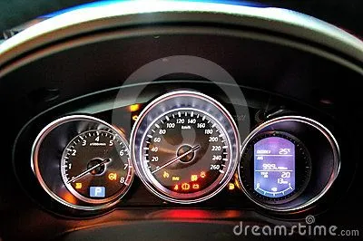

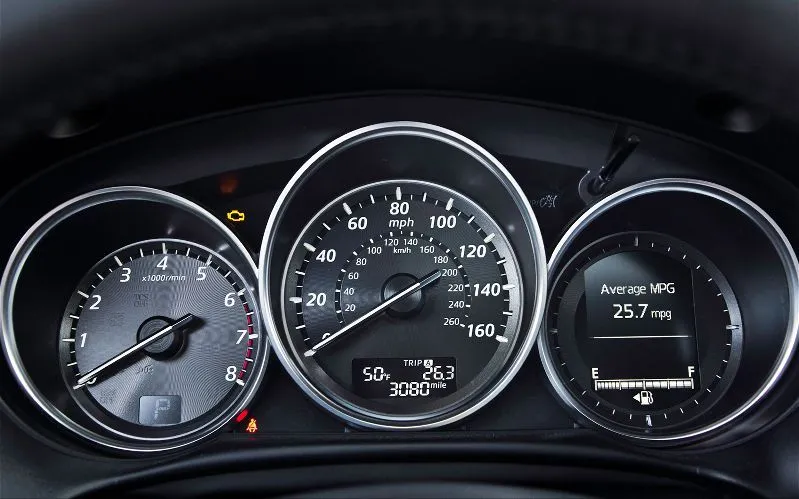

I just bought a 2014 CX-5 Grand Touring yesterday (9/28/13). Upon driving off the lot, I noticed the instrument cluster looked like model B in the the owner's manual. See the first pic and compare model B to model A in the other pic.

The one with the FLAT HORIZONTAL fuel gauge is a model with TECH package. It also has a small screen under the Speedometer. This cluster has more usability and options (info button, maintenance notices, etc).
All others have the curved fuel gauge.
Your cluster can't change from A to B or B to A.
The INFO button is a Select/OK button. Press the Up/Down to navigate to Setup then press INFO to Select/OK it.
Pressing INFO while gauge is showing MPG or Distance Left does NOTHING.
