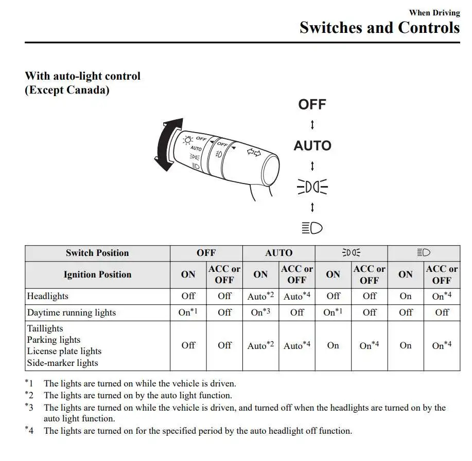

My 23 CX-5 has four headlight choices. Two of them seem to do the same thing. One choice is AUTO, the other is the icon of two lights shining away from each other. Is it purely the illumination of the taillights, parking, license plate and side markers that is the dif? If you don't mind, which choice do you use and why? Thanks

From my understanding:
Off=off
Auto=auto
2 lights pointing away = daytime running lights only
Light symbol = headlights on
I would either switch between off and on, or just leave on auto.

This icon position on light stalk is for “Parking Lights” which has nothing to do with DRLs. In the old days you turn on the parking lights without headlights when you park the car in the dark for the short period of time fo save the battery. Many also turn the “parking lights” on while driving in the dusk or during the bad weather to save the headlights which is more expensive to replace. Since the DRLs coming out, some drivers use parking lights to replace (or in addition to) DRLs while driving as they believe this’s better and safer with tail lights on.
The functioning of DRLs is automatic, you can’t control it unless you go through the steps to disable it permanently.

On my 23, when in two lights pointing away, the DRLs are on but as soon as you start rolling the low beams come on and stay on as long as you are driving. They automatically turn off once you kill the ignition and close the door and walk away.

You mistakenly think the front amber parking lights as the DRLs. For gen-2 CX-5 the low beam headlights serve as regular headlights and DRLs (with a bit reduced power), that’s why many people got confused. As you described the low beams turing on when the car is rolling which serve as the DRL. The DRLs on early gen-2 CX-5 also use both amber parking lights (lower trims) or LED accent strips (used as parking lights on higher trims) in addition to low beams. DRLs should only be on when the car is moving forward. They’re off when the car is stopped or the gear is in reverse. That’s how you tell which front lights are used as DRLs.
The table posted by OP with the foot note also explains when the DRLs are functioning.
Just want to clarify, what Drewwitda22 did was he turned off the DRL function and turned on the parking lights all the time while driving. He gets front LED accent strips (halos) AND tail lights on all the time, and in theory, they’re not DRLs. And in certain states it’s illegal driving with parking lights on.
Gen-2 CX-5 in US and most other regions uses low-beam projectors AND LED accent strips (halos) for DRLs. Some versions of gen-2 CX-5 in other regions do use ONLY halos as DRLs like gen-1 2016 CX-5 with optional LED headlights. Unfortunately this’s something we can’t do on US version gen-2 CX-5 even though that’s the best DRL design on gen-2 CX-5 many have agreed upon.

Thanks to everyone for their input. May I 'assume' that the correct or recommended lighting control position is "AUTO" for everyday driving? Just set and forget. If so, when is the correct time or situation to use the double light position?
At night, especially on unlit back roads, I typically use AUTO with the automatic brights/dimming feature. If you are not already aware you have to flip the stalk to the brights position for the auto brights function to work. It works surprisingly well with few false negatives and positives. Dawn, dusk, rain--where brights are not necessary--I probably just rotate to the old standard last position.
If you’re a driver not wanting to have full control of lightings, you can set the light stalk to “AUTO” position and forget about it. If your CX-5 has optional automatic high beam control (HBC), you can push the light stalk away from you at the high-beam position and let the HBC switching between low beam and high beam for you automatically.
The Parking Light position is rarely been used nowadays. I use it sometimes when parking in the dark; or while driving in the dusk or dawn, or during the bad weather.
The only thing I would question about that approach is that AUTO purportedly turns the headlights off altogether if ambient light is sufficient. One would probably want to test that feature to see how well it works at dawn, dusk or in the rain.
