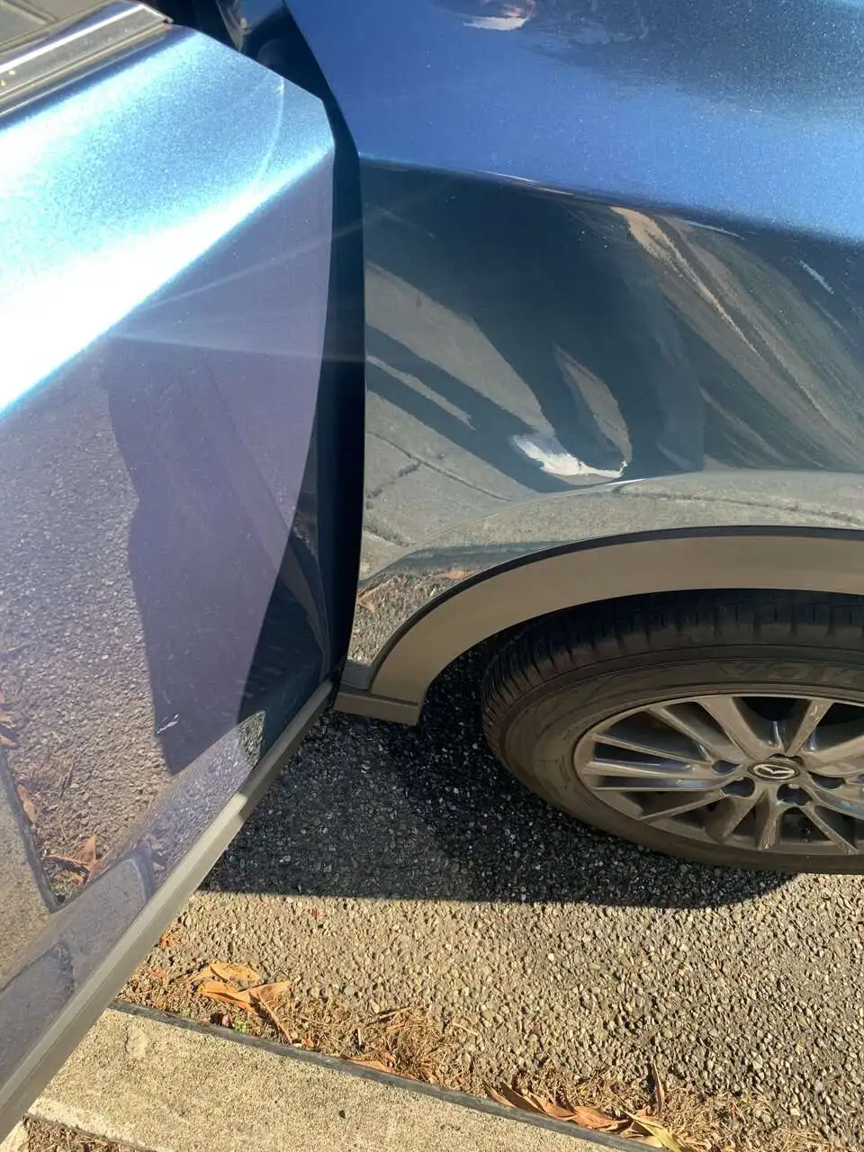

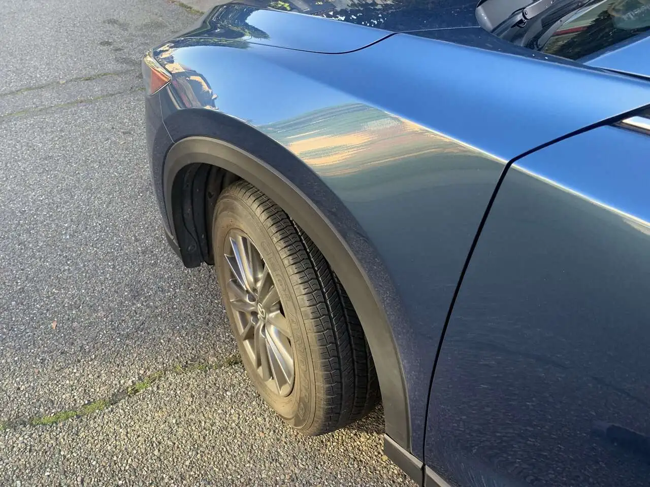

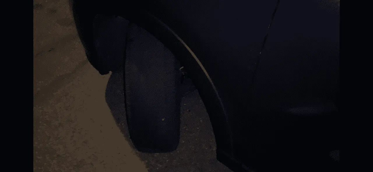

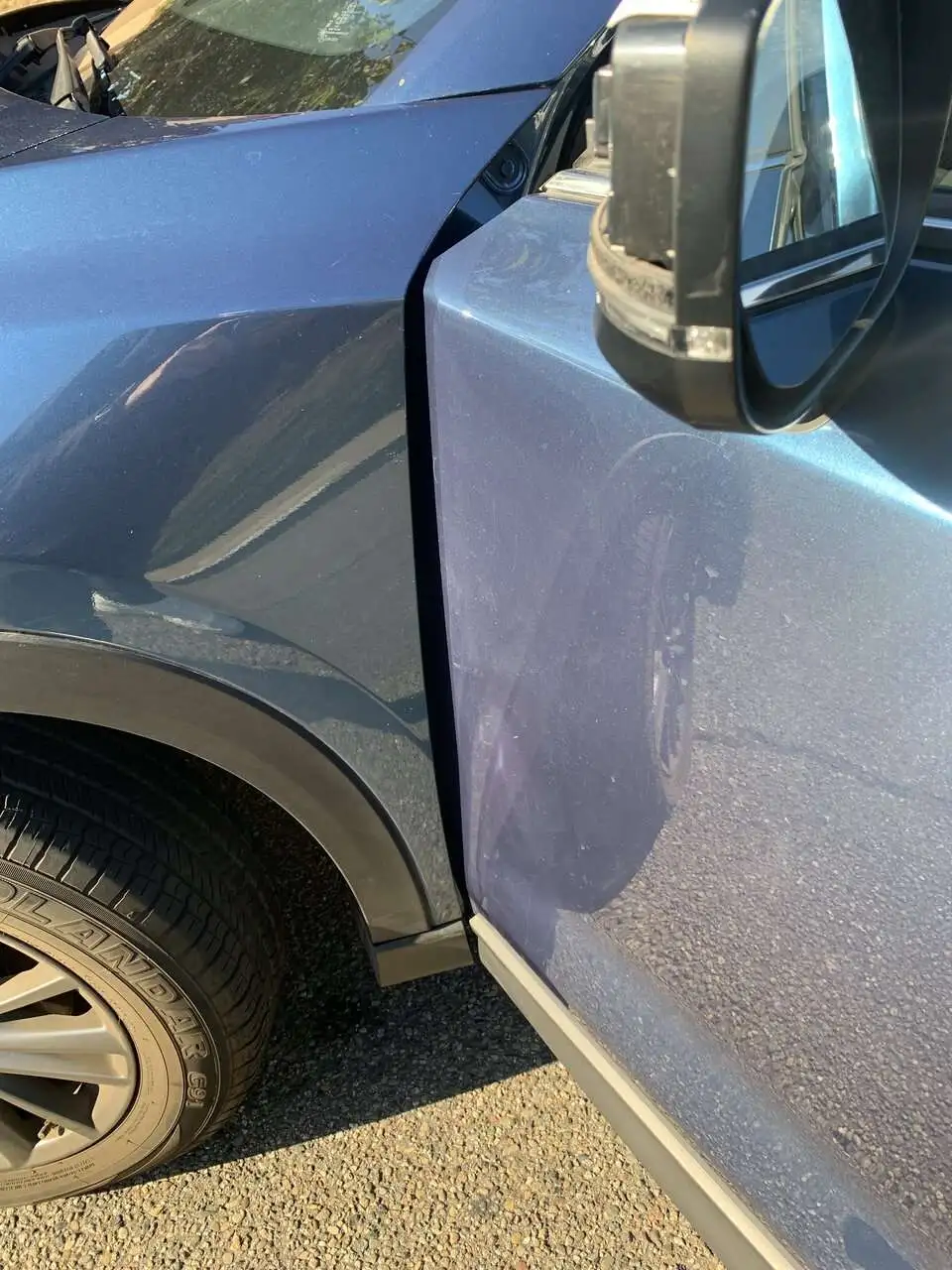

Here are some pictures - as you can see it's very hard to see from the naked eye what is going on. The picture in the dark is night of the impact, the rest are the next day after I straightened out the car to get it out of the street. You can see the right wheel is straight while left is bent in. The video is of noises the car is making when changing the gears. Thanks for all the help, this entire process has really stressed me out.

Nothing indicates frame damage.
Components to be replaced are the left shock, left control arm and left drive-axle.
Once that's replaced the vehicle should be fine.
Once the repair shop tears it apart, they should be able to assess any damage that might have occured to the transmission spool/gear teeth where the axle splines and tranny meet. Doubtful there is any damage, again it depends on the speed , angle and impact of the collision. You should have the tranny evaluated afterwards just for peace of mind.
Once it's at the shop of your choosing they can also assess any frame damage that might have occured.
