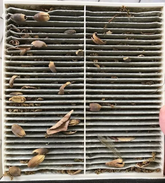

Looks like 18 months is too long between changes here in S Texas with oak trees hanging over the driveway? (nailbyt) This is just how it came out of my 2014 CX-5 today when I finally got around to changing it. Note to self...change cabin filter in 6 months.

FYI OEM cabin filter from factory is charcoal filter and it looks dirty even if its new. And the OEM cabin filter available at US Mazda dealer is NOT charcoal.

My 2017 GTR with less than 8000, and less than a year looked like the picture in this thread. There is no need to get an OEM filter. There are plenty of decent and cheaper filters in the market. And don't have your dealer replace and install. It is a ripoff. It could be done by yourself in fewer than two minutes.

Yeah, It got me when I checked my filter at 8,000 miles. I thought it looked so dirty so I rushed out and bought a new one. Then I find out they come black from the factory. Unfortunately I found out after I trashed the original one.

both my mazdas are parked in the garage, and the 3 is daily driven... I usually use recirculated air mode, and finally replaced it this year when it reached 30k miles, but over 3 years old... it had some dirt/leaves in it, but nothing compared to the pic posted in this thread

That is ridiculous. It looks like there is very little accumulation of dust and fine stuff, just some really large things of a scale the filter shouldn't have to deal with. There should be a grill, or mesh pre-filter.
If that were mine, I'd probably slap it on my knee, or blow it out with compressed air and put it back in. It doesn't look dirty aside from those big pieces.

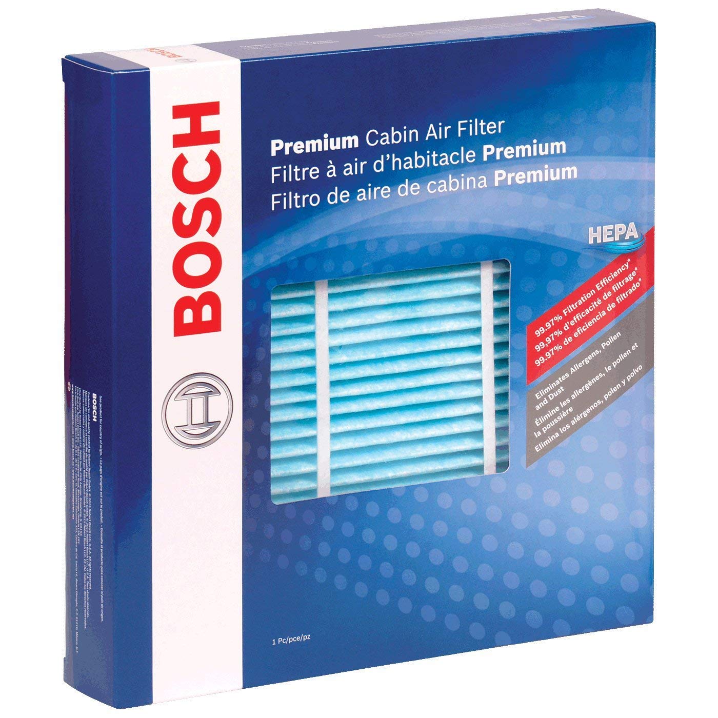

I bought the https://www.amazon.com (commissions earned) off Amazon to replace the factory cabin air filter. Bosch makes HEPA filters sized for most common applications. They are one of the only ones who offer HEPA grade filters for automotive applications. It reduces airflow a little, but I am happy with it. It is a more substantial filter than the standard one and has very fine filtration. These last a while.
If OP's filter is that bad...highly advise to wash the cowl area (below front passenger side windshield). Probably still has some leaves/ect.

Ill do that too. :) Especially OPs cabin air filter is a charcoal filter which looks dirty even if its new.
Definitely clean the outside air inlets on cowl area at bottom edge of the windshield like CX-5um suggested.
The replacement schedule for cabin filter is 24 months or 30,000 miles. Unless you noticed reduced air flow from vents, or you have special needs, just stick with recommended schedule.

Yep...that area is cleaned out every time I wash the car. And system is 95% of the time set to recirc. That crap just makes it through to the filter no matter what.
