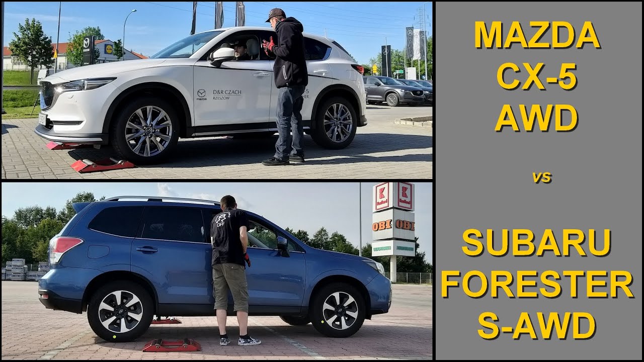

There was a test that a youtube content creator performed with the CX-9. I think if you search for cx-9 diagonal test, you'll find it. In that test, turning off Traction Control as @ColtX-5 suggested helped with getting the CX-9 moving.
There are also a few "roller tests" that were done with the CX-5 that show that Traction Control Off works best to get the car moving in those situations. See below:

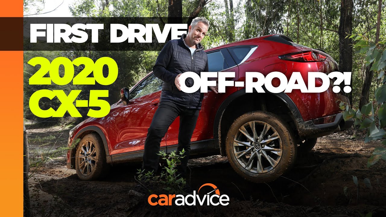

My non US 2020 Signature has TCS with button labelled as such. Probably the newer versions in Colombia have the Off-Road Traction Assist button. Is it really just relabelled TCS or something different? Here's a British youtube video about it. :
Anyway for fun I will go stick my wheel in the same depression, turn the TCS off ,set wippers to high and see what happens. To a question above yes it looked like the same side rear wheel must have spun a little from the impression in the dirt.

Yes that was fun and I concur with the comments. Would like to have seen how a 4WD vehicle would have managed on the log test. Seems there was just one log that stopped them.

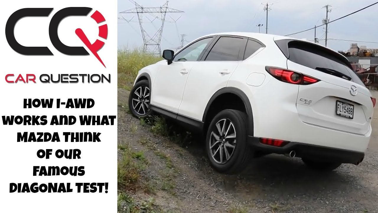

You can check the video below at about the 9 minute mark to see how the brake grab feature on traction control off was introduced to the CX-9 at about the 2018 model year. The Mazda engineer says the CX-9 was one of the last model to have that function implemented. At some point during the video he admits they are looking to change the name of the function in future model year.
