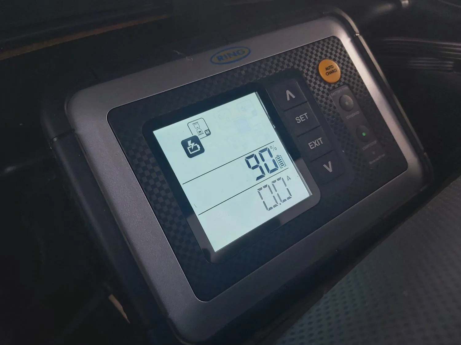

Hi, I recently purchased a smart charger during lockdown. The charger had a button allowing selection between stop start batteries and standard lead acid ones. I connect up the charger for a few days at least once a month for my Mazda 6 and let it run on trickle charge at other times. I added a link showing the details, thought this battery charger may be of some interest. I think it should be available on ebay, it not from the manufacturer. Best wishes.

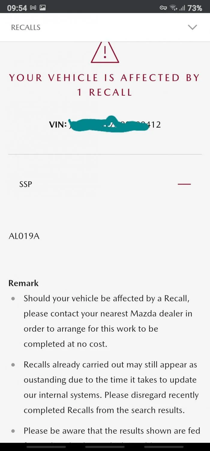

for now, my battery died twice and I called the road assistance, they powered my car up, all good but then I have checked the voltage after 2 days not using the car, it went down to 7v... I have an appointment for the next Wednesday, hopefully, the dealer will do something about as the VIN number is on the recall list.

Please keep us posted as you’re in Europe and many here in the US are interested in this same issue and what the Mazda is going to do about it. We have a Special Service Program (SSP) C2 here in the US, and it’s not a recall. In Canada there’s nothing yet. Your recall info says it’s an SSP (Special Service Program) AL019A. If you could, find out the details of your recall and see if it’s PLG control unit related. And please take a pictures of your factory battery (and replacement battery if it’s needed) showing the brand name on the side if you have a chance. If you ever received a replacement battery, it should be a different battery made by a local battery manufacture.
