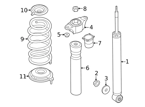

Yes, the top mount of rear shock absorbers on gen-1 CX-5 is included in OEM rear shocks, but not included in aftermarket shocks. Worse, the top mount isn’t available separately from either OEM or aftermarket. And the top mount had been improved a couple of times along the way during gen-1 CX-5 production cycle. So it’s very important to check the condition of the top mounts of rear shocks on gen-1 CX-5 if you plan to get aftermarket rear shocks as there’re reports that those rear shock top mounts are cracked or broken and can’t be reused.
The top mount of rear shocks on gen-2 CX-5 is a separate part and available from Mazda.

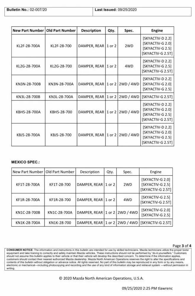

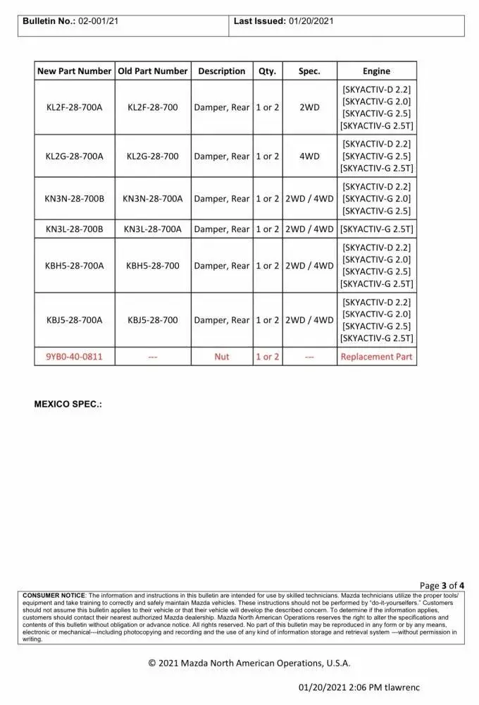

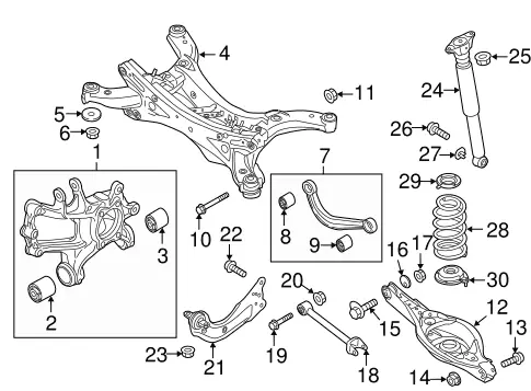

If you’re interested in OEM rear shocks, make sure to use the VIN to verify the correct part number from a local Mazda dealer first. There’re too many different part numbers from Mazda on rear shocks, and you want to get the right ones.
It surprised me that there’re so many versions of OEM rear shock absorbers on CX-5 for different MY’s and FWD / AWD. On the other hand, KYB listed only 2 for CX-5, 349219 to 5/13/2013 and 3440013 from 5/13/2013 up to 2018 MY.
There were design changes along the years on OEM rear shock absorbers which does get confused. So for OEM rear shocks, the best way is to use VIN with Mazda parts department to get correct p/n for the CX-5.
For OEM rear shock absorbers. #24 in the diagram, here are part numbers for gen-1 CX-5:
KDY5-28-910C Shock absorber for 2013 ~ 2014 Mazda CX-5 to 5/13/13.
KR27-28-910H Shock absorber for 2014 ~ 2016.5 Mazda CX-5 from 5/13/13, Type 2, without AWD.
KD35-28-910K Shock absorber for 2014 ~ 2015 Mazda CX-5 from 5/13/13, Type 1, with AWD.
KA0G-28-910G Shock absorber for 2015 ~ 2016.5 CX-5 from 11/03/2014, with AWD.
For OEM rear shock absorbers and shock top mount, #1 and #4 in the diagram, here are part numbers for gen-2 CX-5:
KB7W-28-700B Damper rear for 2017 CX-5 to 06/22/2017, with FWD.
KL2F-28-700A Damper rear for 2017 ~ current CX-5 from 06/22/2017.
KL2G-28-700A Damper rear for 2017 ~ current CX-5 from 06/22/2017.
TK48-28-380C Shock mount for 2017 CX-5 to 10/01/2017.
TK52-28-380C Shock mount for 2017 ~ current CX-5 from 10/01/2017.

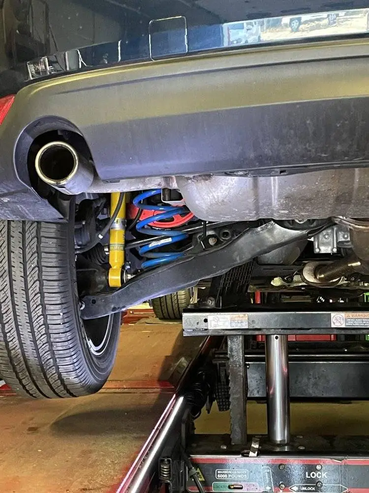

2019 CX-5 grand touring reserve
B6’s in the rear with cork sport springs and Godspeed camber arms
yrwei52
2016 Mazda CX-5 GT AWD w/Tech Pkg
Contributor
Plano, Texas, USA
So Bilstein now offers (expensive) rear shocks for CX-5? Always wondering why there’re so many versions of OEM rear shocks, but aftermarket shocks can be “one-size-fit-all”?
And why the rear bumper cover is removed for rear springs / shocks / camber arms installation?
