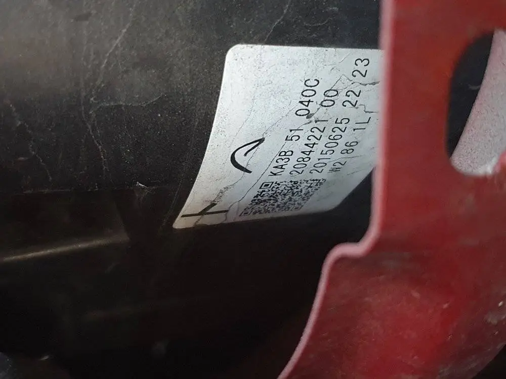

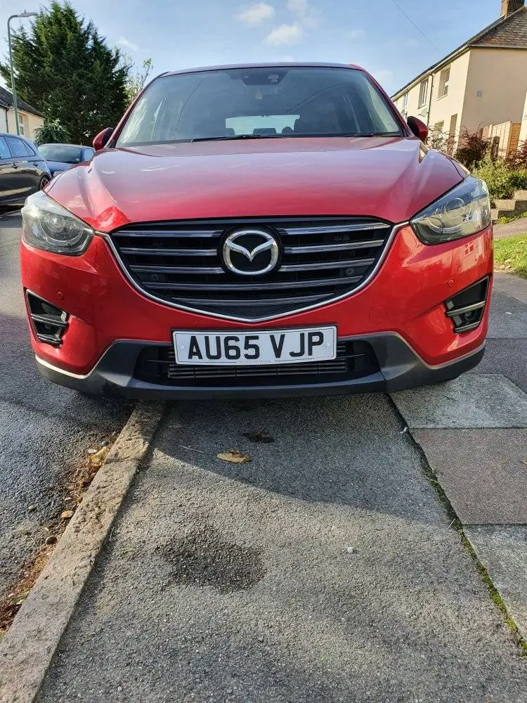

Hi there,
I own a 2015 MAZDA CX-5 SPORT NAV D 4X4, right hand drive (UK), and wondering if any of you swapped the OEM headlights with aftermarket units. My issue is that the left headlight DRL has failed, a common issue for this car model, and the OEM headlights are insanely expensive, the whole assembly on this side needs changing.
Obviously the Chinese people say that the headlights are plug and play, but if any of you here is familiar with my trim I was hoping I can be advised whether or not the aftermarket units will fit. Ideally I should check the plug, but before removing the front bumber I thought I should ask here.
I have attached some photos hoping it would make it easier for anyone able to point me in the right direction.

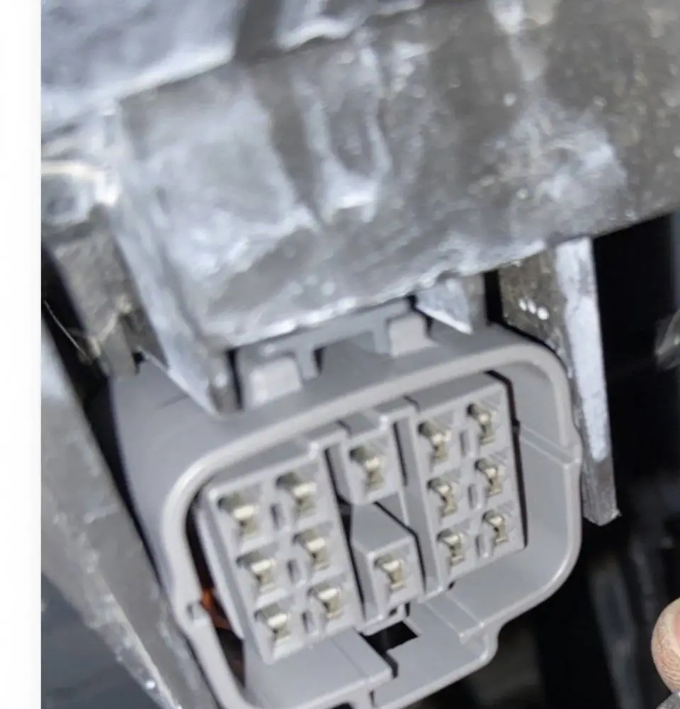

without the vin its a bit tough
but try in google part no. -> B1Y4-67-SH3
with and without the dash. That should be type of the plug of the lamp harness. There are pictures in google, also on ebay.
From what I see there are 2 plug types - one is the halogen w/o leveling and the other plug (bigger rectangle) is for the xenon, led or halogen types w/ auto leveling.
The EU plug should be 14 pin.

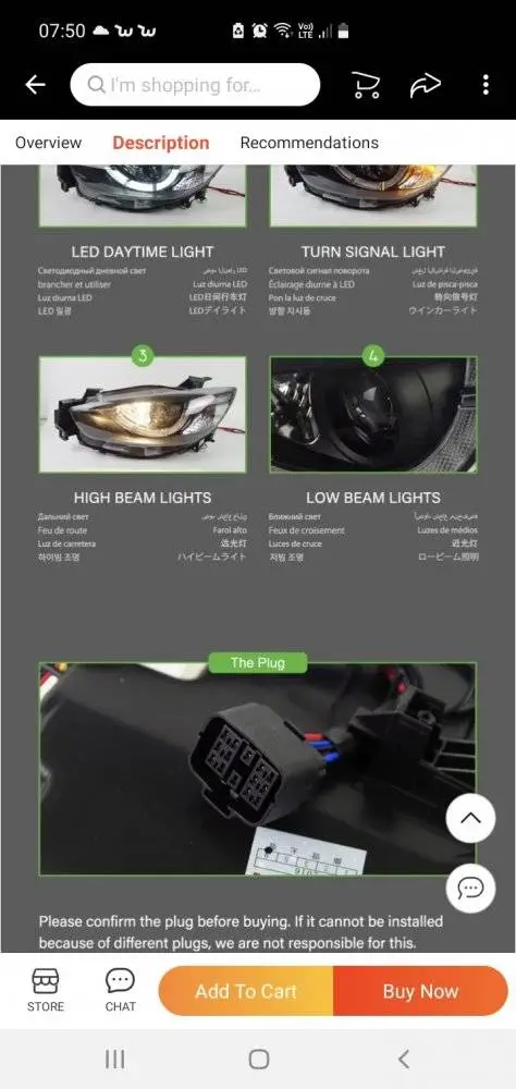

Gents, thanks to cz5gt I did a research for the plug over the Internet. Still not 100% sure if this is my plug or not, but the seller confirmed compatibility after sending the headlight part number. The photo with the plug sent by cz5gt matches the one shown on the seller's photos as well so I thought I should give it a try. It remains to be seen once I get the headlights.
The reason I'm not keen to buy from scrap yard is because there is a massive design issue with these headlights for KE models, you never know how long are they going to last and the price is >£300 for one headlight.
Just in case anyone can check and confirm the plug type based on vin number (JMZKEN92600439618), I still have time to cancel the order in the worst case scenario 😁 Thanks.

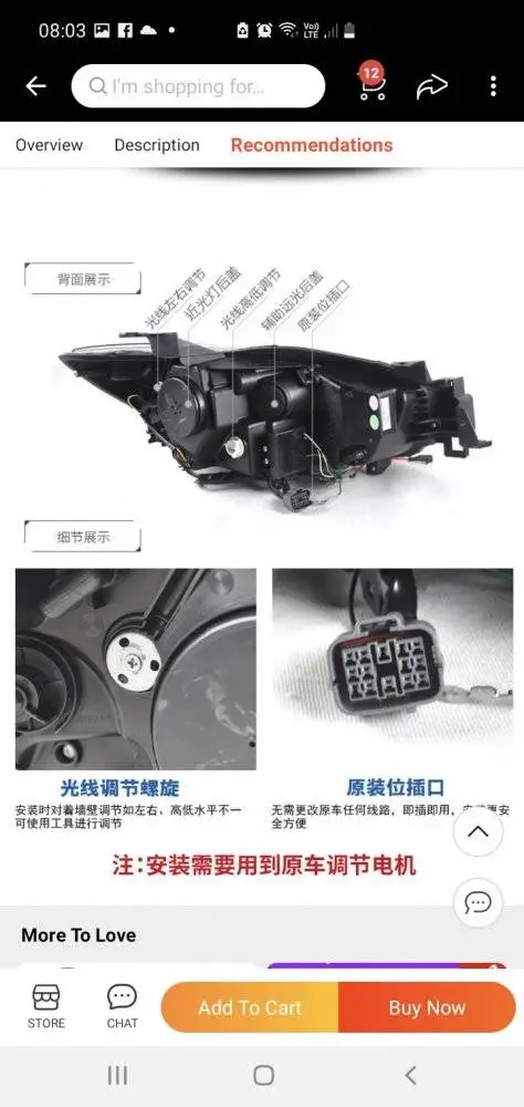

No success with Chinese headlights, after making the payment they confirmed not suitable for RHD so I've got a refund.
Managed to get it sorted with an UK supplier, bought the headlights from them and installed myself. Can't advise about the afs, never had this option but I do have the motors on original headlamps. I've noticed in the instructions though that you have the option to use motors from original headlights so I used mine on the newly purchased items.
All works great but as I never had afs activated on my car I don't know how it would work. However, considering that this function is all about your front camera and headlamp motors which you put in the aftermarket headlights, it should work without issues.
Link from the merchant here if it helps
