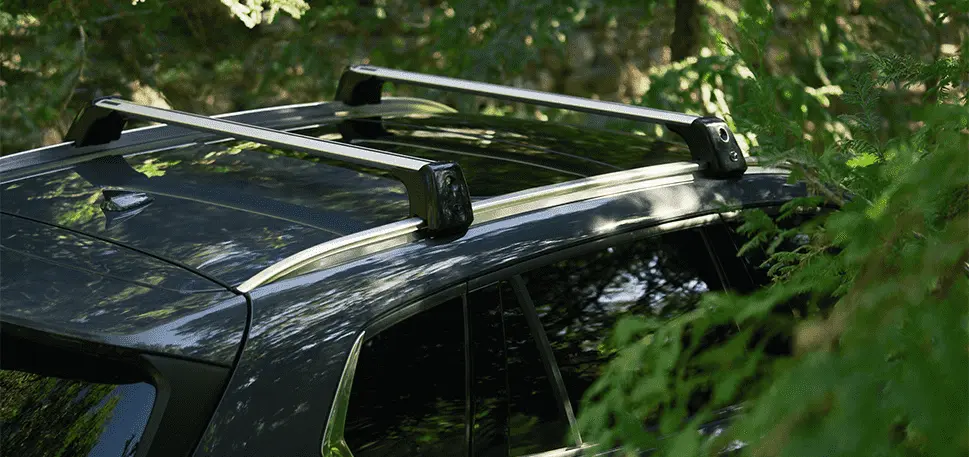

The crossbars of CX-50 appear to be adjustable.
No so for the CX5 ones.
It also seems that the rails have no holes in them (unlike the CX5's).

Assuming you mean aftermarket vs the factory Mazda crossbars for the CX-50:
The Yakima Ridgeline base towers I currently own along with the Jetstream Aero bars on the CX-5 supported 165lbs, which as reported elsewhere seems to match the CX-50 OEM bar's limit. The limitation here is the bars themselves, versus what the actual roof weight can support (CX-50 is much higher than the CX-5, I think ?? at 600 lbs with the factor roof side rails). So, weight limit seems to equal between OEM and aftermarket bars.
Can't be sure yet, but it visually appears that that the Yakima towers + bars may sit higher than the OEM single piece bars, so if true that provides more clearance over the roof for anything that might sit below the bars.
Flexibility--aftermarket towers/bars can often be used on different vehicles as long as you get the correct attachment/base clamp kits, whereas the Mazda OEM bars are usually vehicle-specific.
And lastly, sure, aesthetics might come into play. ;)

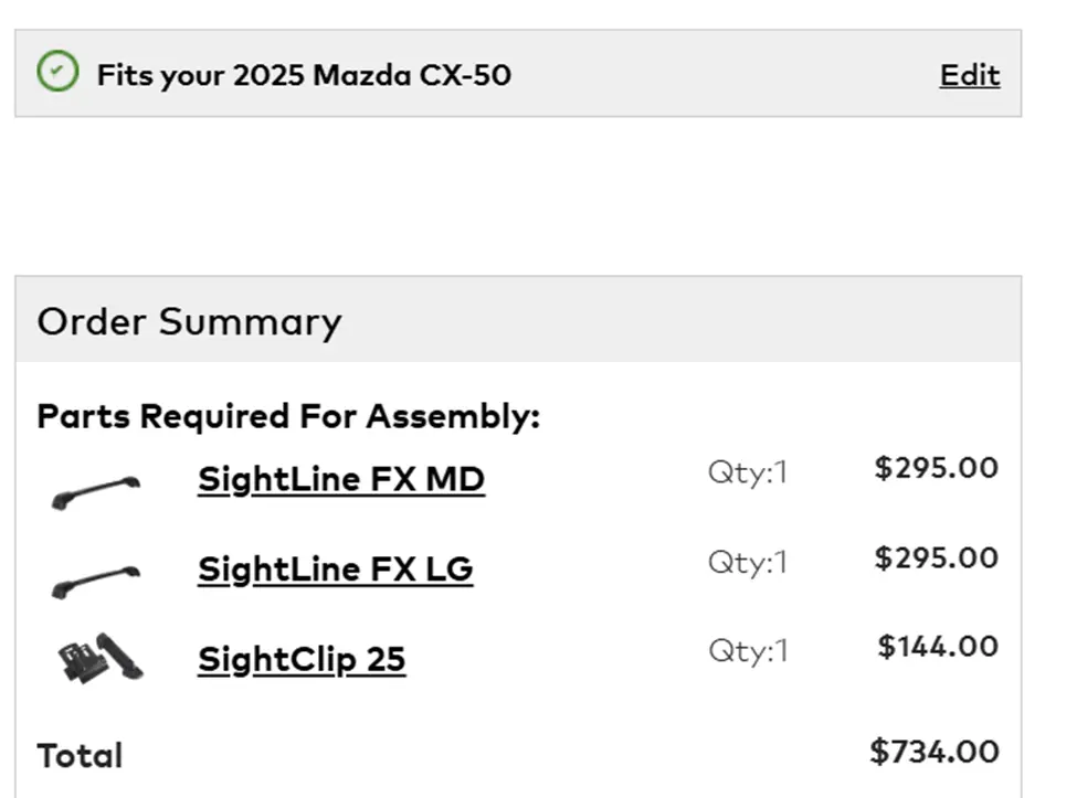

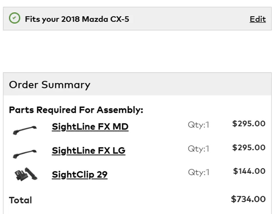

According to Yakima it appears the only difference between the CX-5 and CX-50 rack is the clip. The same clip is used for all Yakima towers, including the SightLine and SightLine FX.
