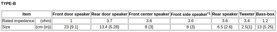

I was always ready to replace the rear speakers, but specs for the rear door ones with Bose don't seem to exist, hints appreciated.
Crutchfield recommends 4ohm ones, can it be trusted?
Not sure if Kicker would be better than stock Bose but willing to try
