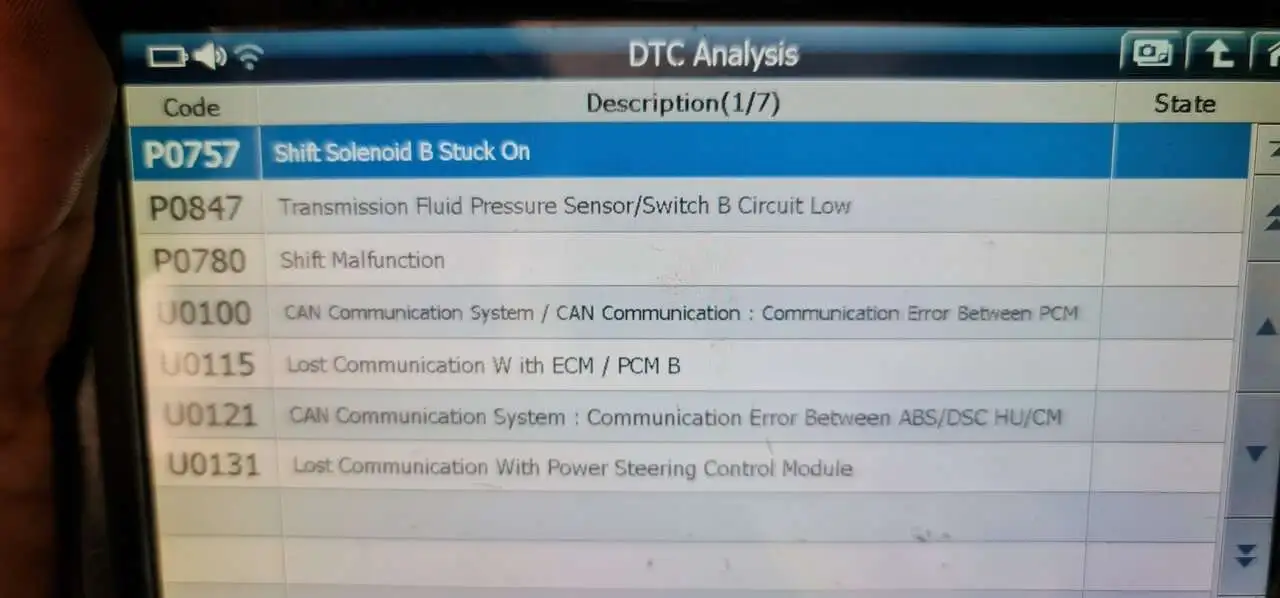

its done 41K miles and never changed the ATF. Attached are the Trouble Codes.

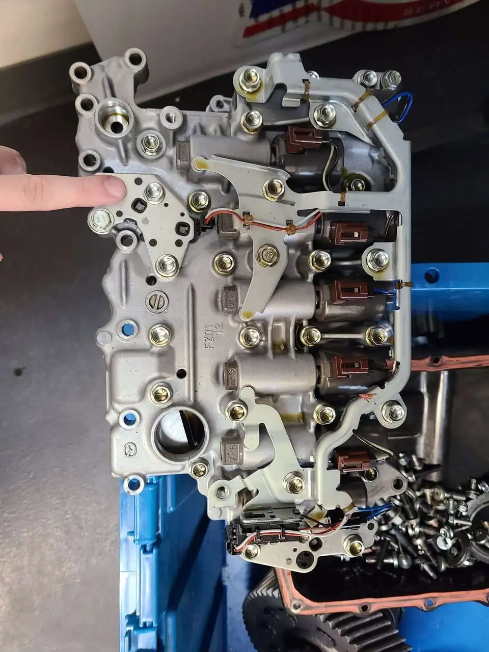

This TSB may relate to your situation. FZ has a little different smell than many ATFs and has a more acrid/chlorine like smell. If it is really burning you have a clutch set that is starting to fail and the issue may be deeper than a pressure switch. It is however not uncommon to have the switches fail. The first step is to pull the pan and see what debris is there. I've seen the switches fail on their own and I've seen them fail because they get a piece of debris inside them. It seems that part of the TCM update is done to make them less sensitive to debris. The caveat being if you have enough debris to cause the pressure switches to fail you have premature clutch wear happening. Pressure switch B is the one in the picture I'm pointing to.

Will approach the local garage to do this. While Inspecting the pan and if needed this can be replaced with new ?
