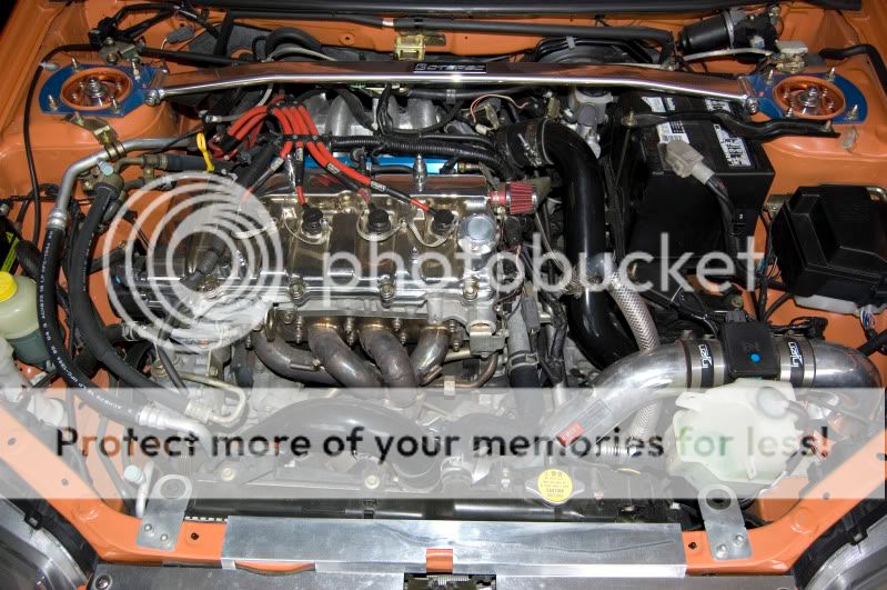

uummm...not being a dick or anything, but your camber plates are installed incorrectly. (nailbyt) right now, the way they're installed is only for caster...forward and back, with no camber.
it should be an easy fix though.
jack up the car, remove the strut bar and push down and rotate the camber plate to its proper position. car will probably drive a whole lot better too.
oh, but nice looking engine bay otherwise! :)

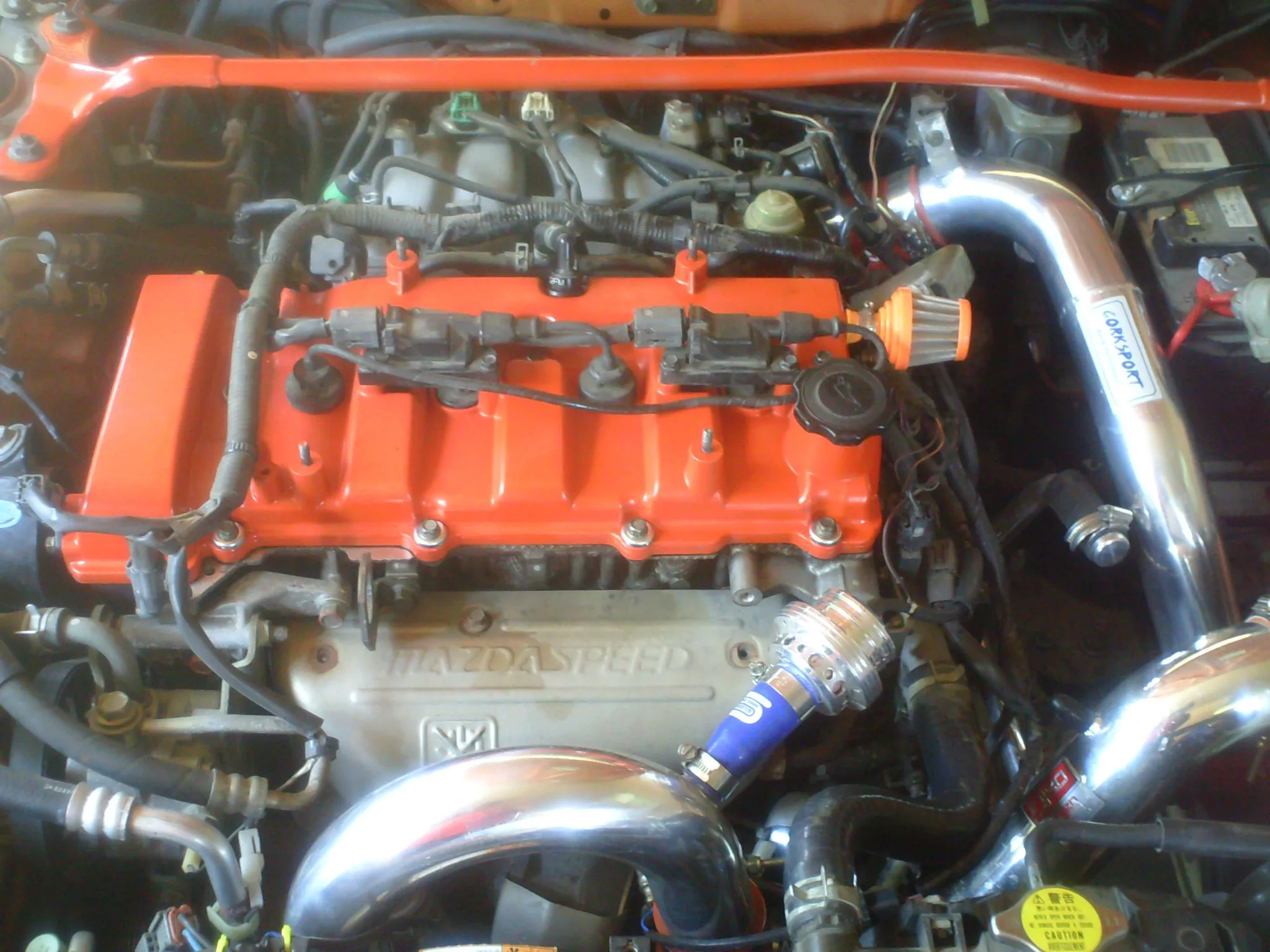

Here is a pic of my engine bay on my MSP. I recently took the Forge BOV off due to backfiring between shifts, surprisingly no stalling issues though(did not relocate the MAF sensor). But anyway, Im running the stock bypass valve until I can get a better bypass valve or BOV recirculated.

You know I was actually trying to find pics of them installed on something else the other day cause I figured they weren't on right. I appretiate you letting me know, I'm not much for fiddling around and adjusting the suspension too much but I'll definetly be switching them around now. I'm assuming after dropping them down and turning them I'm gonna have to get another alignment? Correct me if I'm wrong about this.

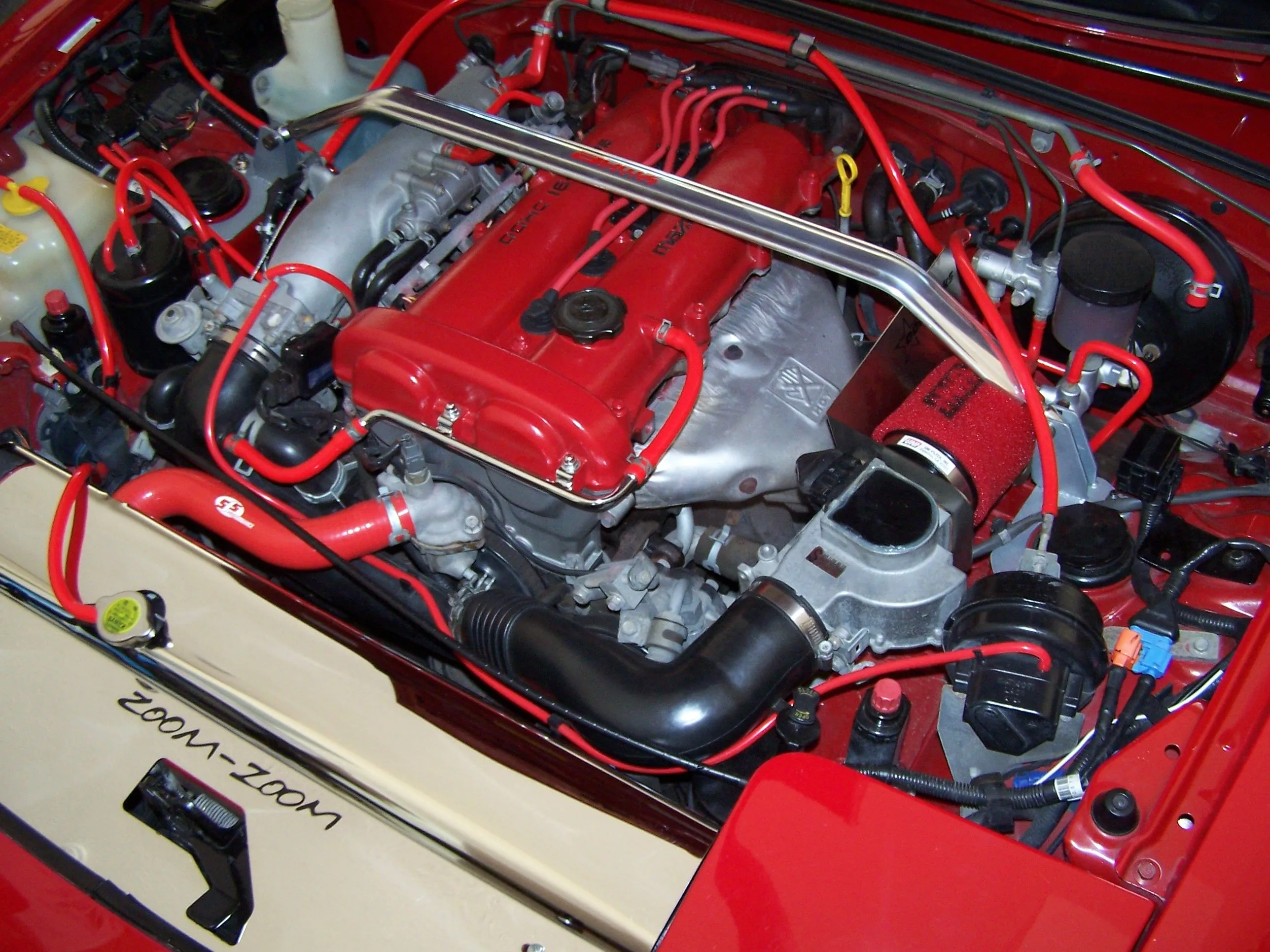

16 year old engine bay!!
