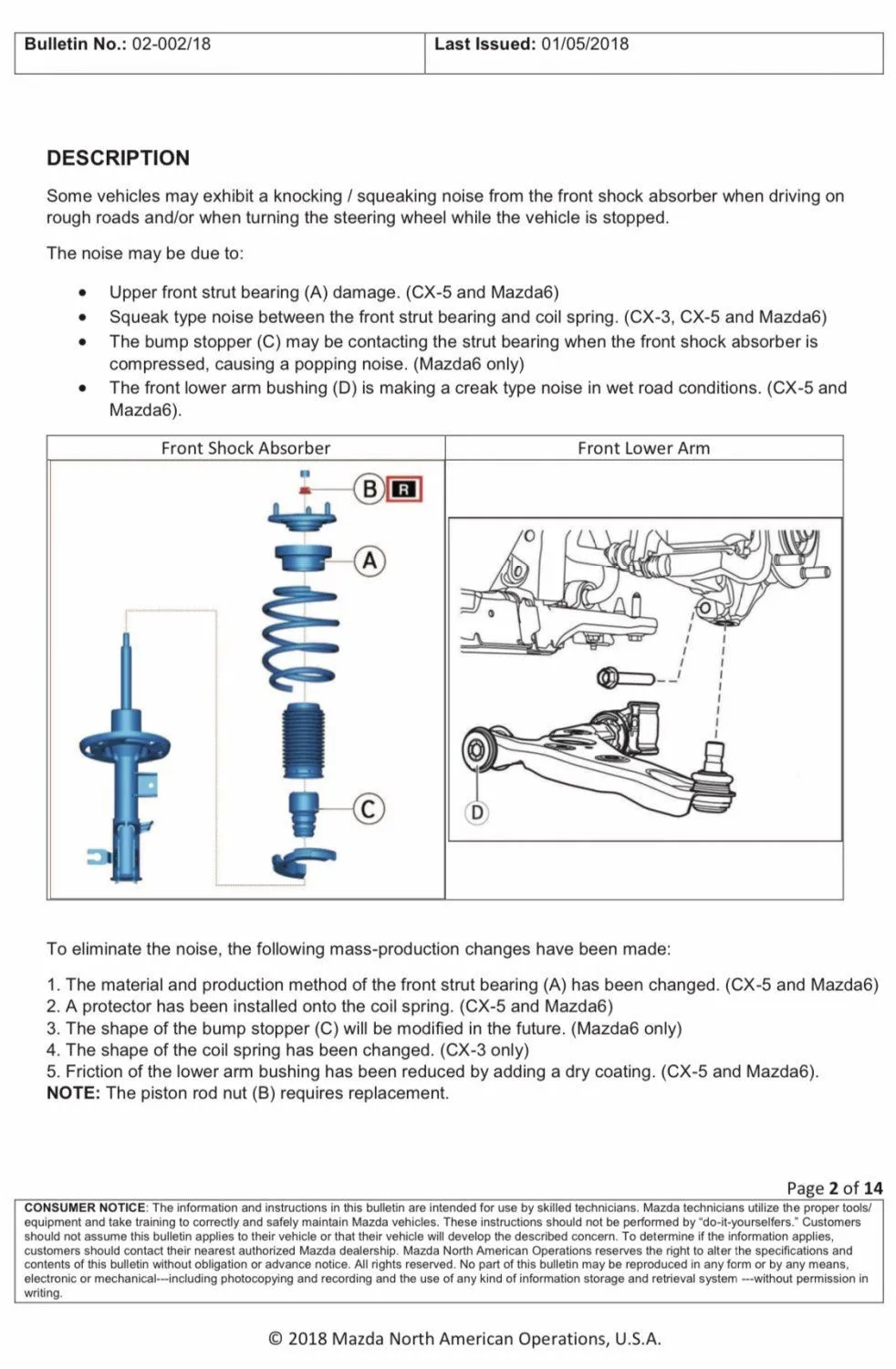

If you still have new car warranty, you should take your CX-3 to a Mazda dealer checking it out. There’re multiple issues which may cause front suspension noises on earlier gen-2 CX-5 so as CX-3. Check out this TSB 02-002/18:
Click/ Clunk/ Knock sounds 2018 CX 5 AWD

Right after I got my 2014, I complained to the dealer about a groaning sound from the front end while going down a road that that slight undulations, not even bumps. It's been a long time but I remember it being worse when cold as I noticed it early morning on the way to work. Anyway, there was a TSB and they changed out the lower control arm bushings which cured the problem.

Hey, I took it to Mazda. Pretty crappy experience where I waited in the showroom and didn't get to speak to the mechanic so I had get infrequent updates from an 'intake specialist.' Anyways, she said they couldn't hear the noise and then they did, and they tightened some bolt and now it's gone. Well wouldn't you know 20 minutes later the noise is back. I think he just couldn't hear it because he wasn't driving on a hill (I live in SF so lots of those).

He was pretty cool and he heard the noise. I showed him the TSB but it's less of a knock or click and more of a creak or groan. He thinks its the left lower control arm so I'll give it a shot if it's covered under warranty.
