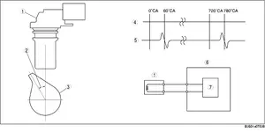

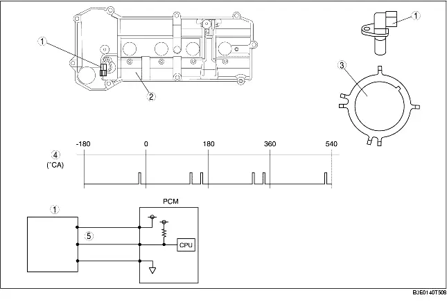

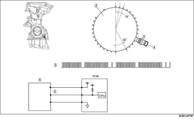

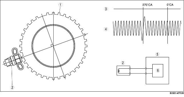

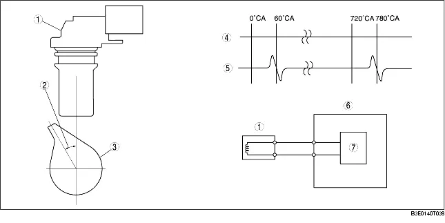

does anyone have a good set of pictures for the cam gears and/or the crank pulley (Mazda 3i and 3S). I need to see them visually to get some info for the Microtech stuff we are doing. Any help you guys can give is appreciated!
Thanks,
Steve
NSN Motorsports, LLC
I just need to see if they have the nubs in the same spots roughly as on the Protege... basically figuring out how the cam sensor operates on the 3 versus the protege...
Same thing and reason for the crank pulley... I've heard it is the same but really need to be sure!
Thanks!
Steve

A little, but not enough.. I need to be able to count the teeth on the crank pulley.. and I need to see what the cam sensor is registering off of on the cam gears... the cam sensor is in your valve cover similar to on the Protege right?
Yea, its inbetween the cams, and ill take a better pic for ya tomorrow. ill even throw in one of the sensor for free....
That'd work.. otherwise all I'm after is to figure out what the signal will look like... basically need to know how many nubs are on the gears, where they are (aka BTDC etc). But cams would certainly do it! :) Whatever works best for you.

I actuallly see now from the manual that it looks like it triggers the cam sensor off the #4 end of the cam rather than from the #1 end at the gear.
Sir Bob and mazda3zoom... you guys are officially my heros... I have everything I need now. I'll mark you guys down for free shipping and 5 dollars off any order for you guy at any point for anything but autometer gauges (sorry.. I make about a buck on each gauge with shipping. LOL).
Below is the information I needed, and now officially have :)
