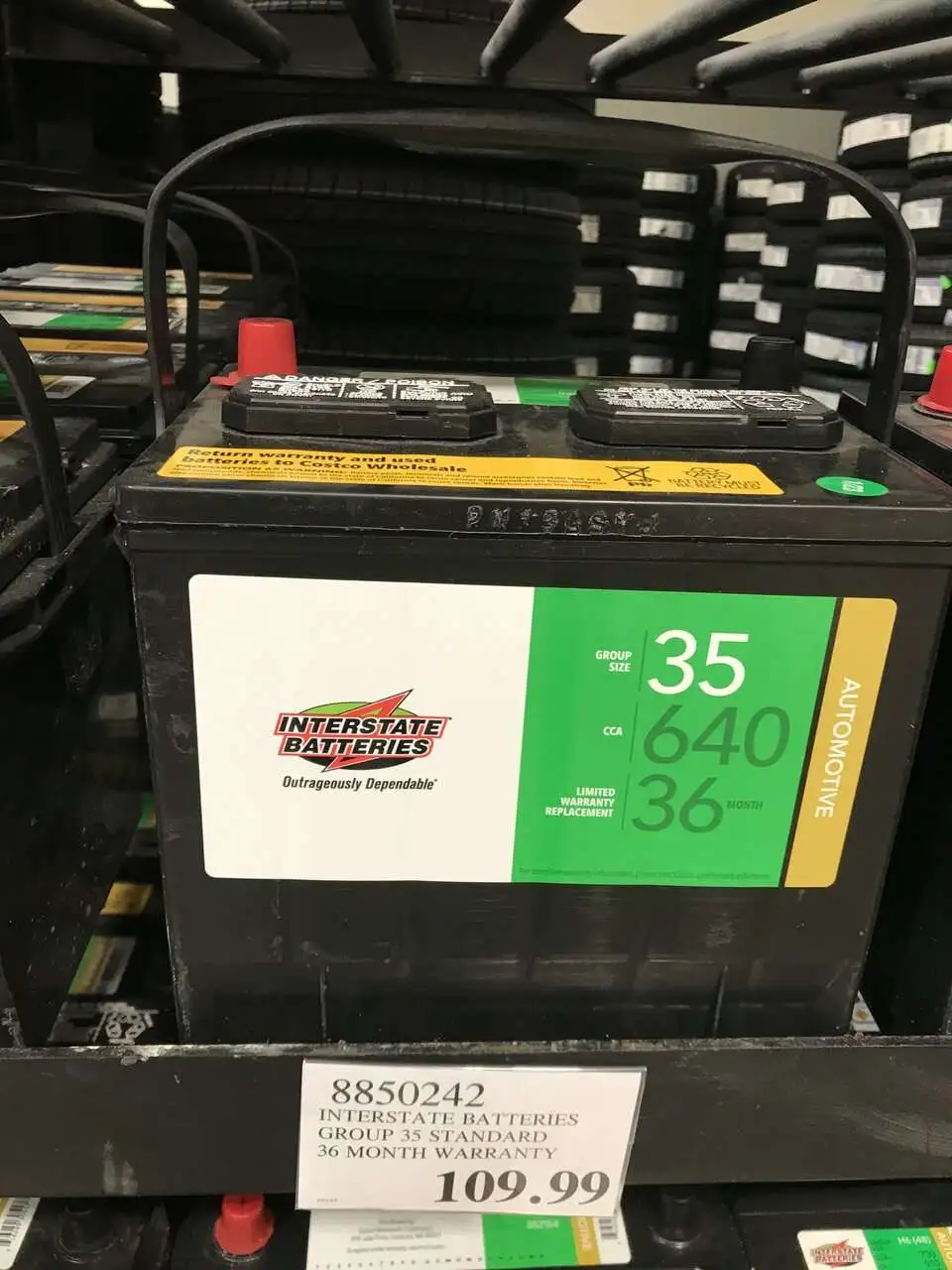

Costco has the Interstate GROUP 35 standard battery for $110 (CCA-640 CA-800)
https://costco.interstatebatteries....04&choice3=2043025&choice4=2043028&Country=US
They also offer the AGM version for $180 (CCA-650 CA-800)

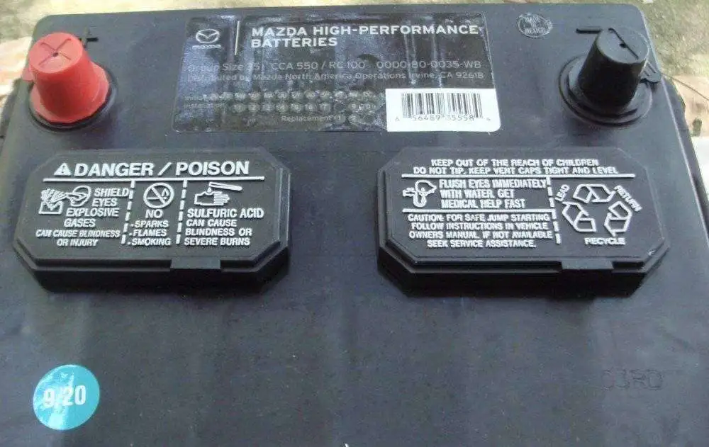

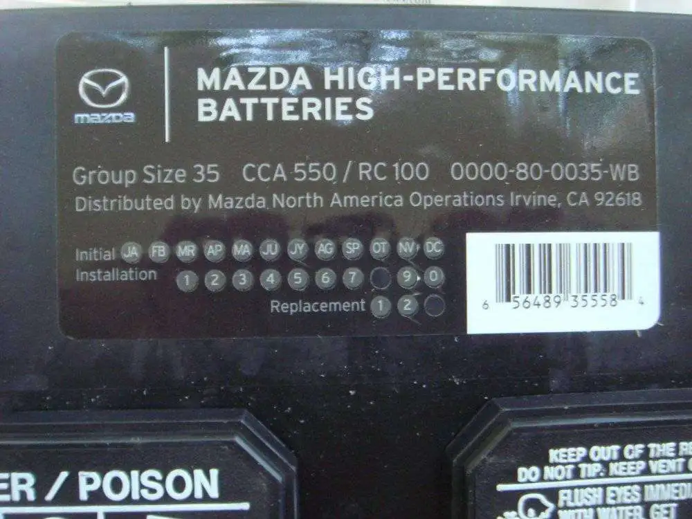

You can’t get Panasonic auto batteries (now owned by Yuasa) in the US. The OEM Mazda “High-Performance” battery selling at Mazda dealers is the Interstate battery with 550 CCA instead of 640 CCA from Costco.
So it looks like I will go with the standard Costco Interstate battery for $110.
