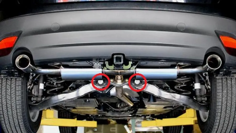

Here is a picture about these:
They are adjusted only on the rear part of the control arm? If yes, then you are right. It adjusts the control arm in an angle-toe. But if adjusts both "arms" of the control arm, then it seems like it pulls in and out the control arm, which could adjust the camber angle.
