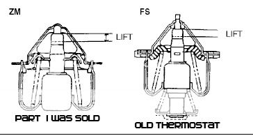

Thanks for the input so far. I'm going to give it one more shot here in a bit. Was told I should have the front end jacked up at least 6". Makes sense allow gravity to work better for you. If this doesn't fix it I'm picking up another thermostat and taking it to my buddy who is a mechanic he'll do it for free as long as I do some tire and oil changes for him.
It made a big burp right after I changed the thermostat. I filled the rad up and started the car and after a bit the rad emptied so I kept filling it up till it stopped going down. Both hoses were hot. Still not much heat. I shut the car off. Later on I went out to pick my gf up from work, I didn't get much heat on the drive when, i got to where she works i popped the hood and the upper hose was hot and the bottom cool.
