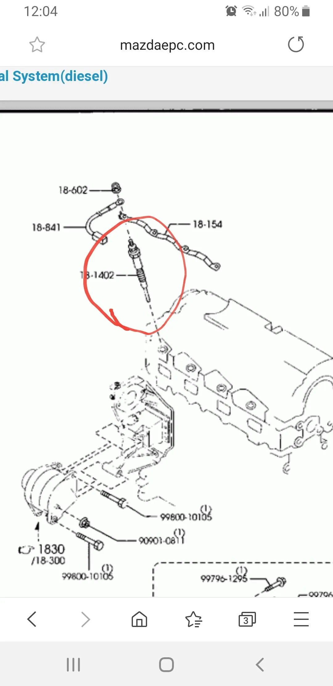

Glow Plug? This is a diesel? Didn't know they made such a thing?

yes mate this is my engine has 4 plugs
