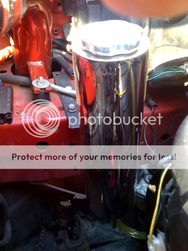

have i need to put a nipple in the part of the tank? or put a straw inside of the tank, for make the coolant flow from the reservoir tank to the radiator??
here is the point, i have the obx coolant reservoir tank, and i installed in my car, but the coolant dont flow from the tank to the radiator.
That to me looks more like an oil catch can and not a coolant can.... I would try adding a small peice of hose in it to direct it to suck the water from the bottom of the can instead of a straw.
Id have to go with stealth. That's not a coolant tank, thats more of a oil catch tank. . Ill post a pic of mine in a main. You wanna look for a coolant OVERFLOW tank not a catch tank. Thats how the coolant system works. Your not trying to filter out debris from the coolant are you? lol

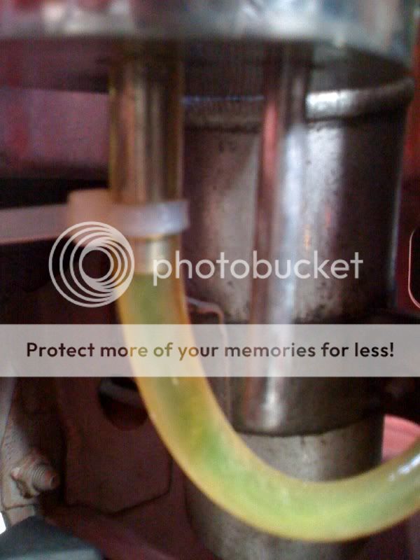

well i have to put a hose inside the tank to things work.
But i can put a nipple in the bottom of the tank, too.

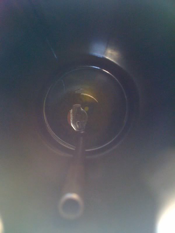

inside shot. the tube sticking out is the overflow tube. down on the bottom is where the coolant is fed from. This also has to somewhat be below the radiator so it can gravity drain.
