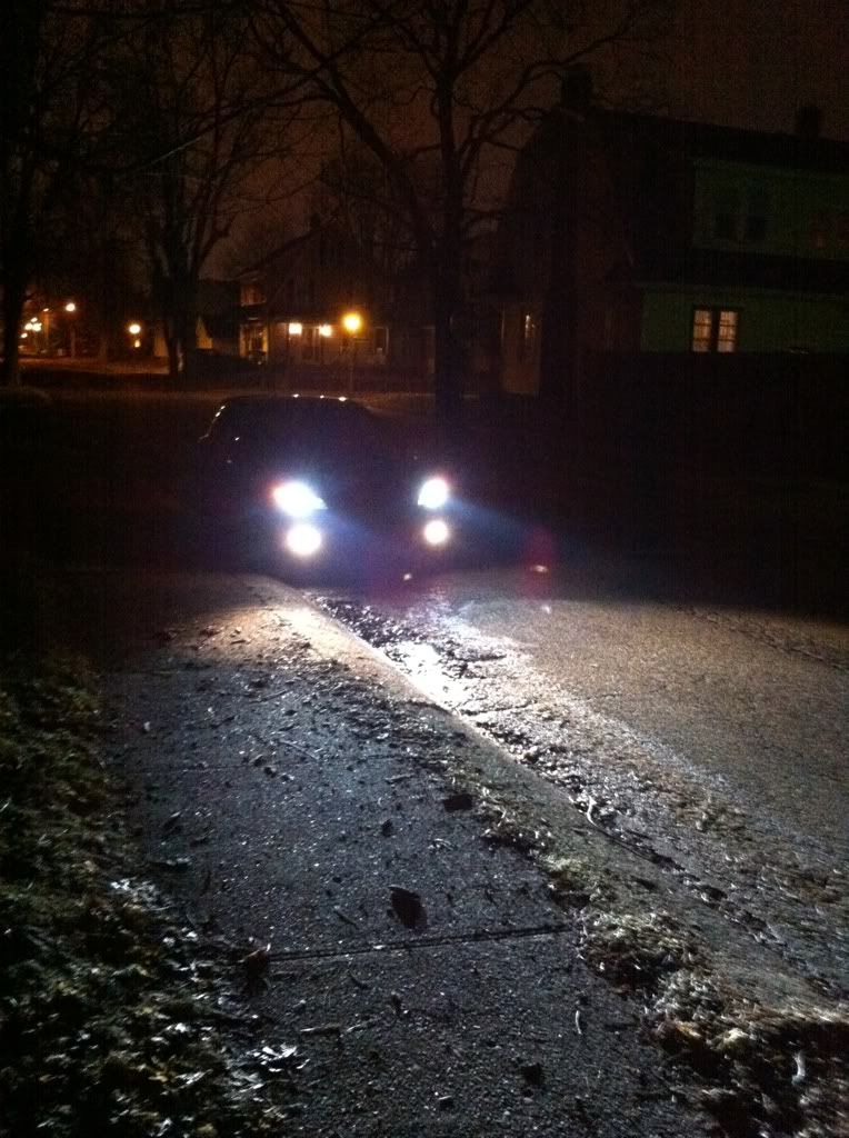

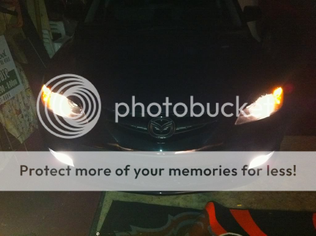

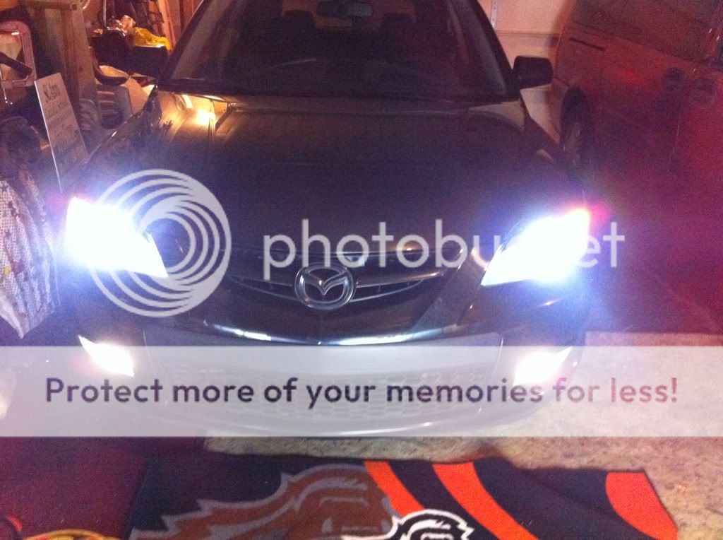

Before and after. Apexcone kit 35w 8000k.
