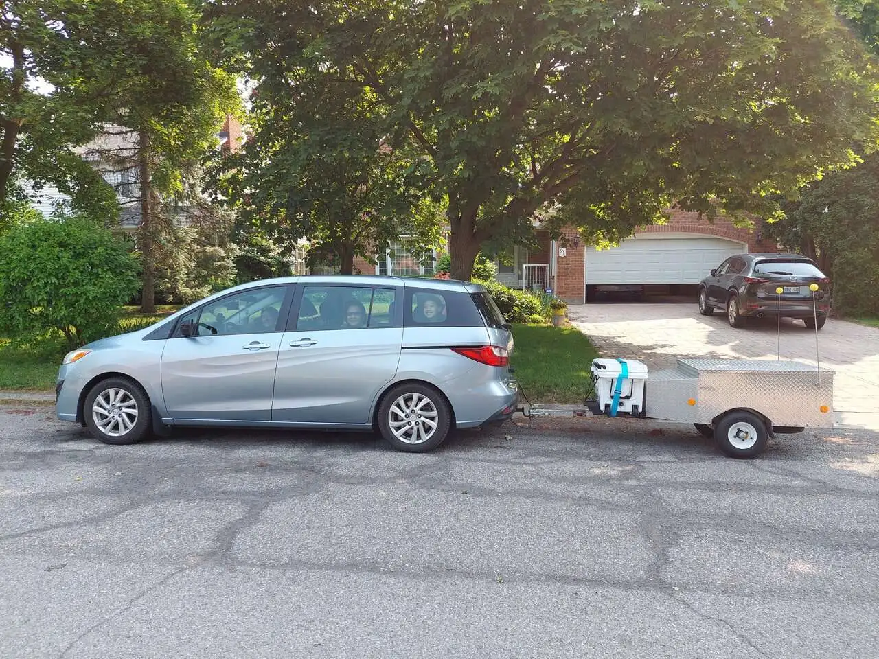

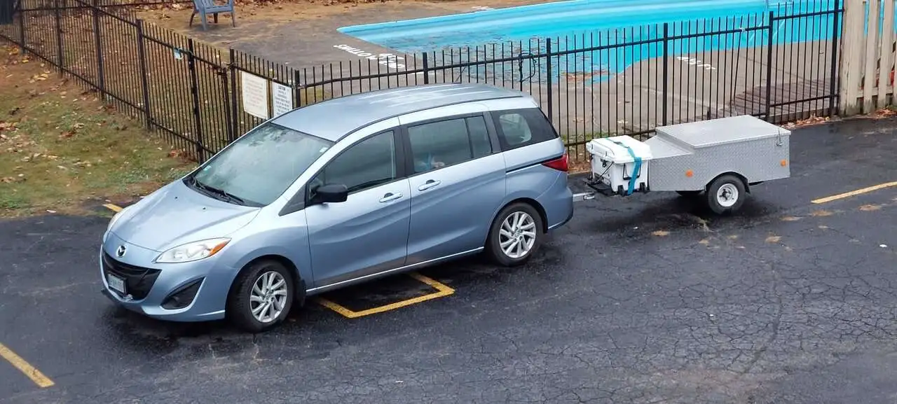

We've had our 2012 Mazda5 Touring since 2012, bought as an ex-daily-rental with 36,000 km. It's a fabulous little van that has taken us across Canada three times with no issues (the latest 10,000 km trip had 4 adults and one 12 year old aboard, and we were towing a luggage trailer. We averaged 9.1 litres /100 km (26 mpg US / 31 mpg UK) fully loaded on all kinds of roads, with aircon on the whole time).
It's now at 190,000 km, and the only issues we've had are a failed horn relay and very slightly noisy rear wheel bearings (which are still original, still in place, and not worth replacing since they still perform perfectly). Good tires are definitely worth the outlay... the standard-issue Continentals are dreadful and short-lived; we splashed out on a set of Michelin all-seasons and can't believe the difference in ride and performance.
We added:
- a Mazda OEM tonneau cover for the luggage compartment, which looks good and adds security;
- a set of Mazda OEM side window screens to protect our then-infant daughter from the sun (still useful for privacy);
- an aftermarket U-Haul trailer hitch, used to pull both a 13' Eriba Puck caravan and a homebuilt luggage trailer (right across Canada this year - Maritimes to BC coast);
- a rear backup camera.
During COVID, we temporarily yanked one of the second-row seats and replaced it with a Porta-potti. With our electric cooler in the back and the window screens on for privacy, we had a great little day-tripper van that made negotiating the pandemic a lot less onerous.
Niggles about the vehicle:
- crappy driver's seat in the base and Touring models (durable but cheesy black 'wetsuit' fabric, with poor lumbar support and inadequate height adjustment - I use two gel pads as a result).
- factory sound system is awful - the worst stock speakers of any car I have ever owned. Head unit is proprietary, requiring an adapter kit to swap out (never bothered... too much fuss). Controls and features are OK, but it's
Overall, it is a fantastic little van, much more versatile and economical than any SUV, and capable of seating six comfortably.
We don't drive ours on our salty winter roads... it goes into storage at the first sign of road salt, and comes out in the spring, which is probably the main reason it has been so trouble-free.
We added:
