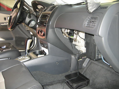

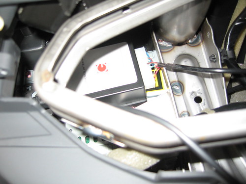

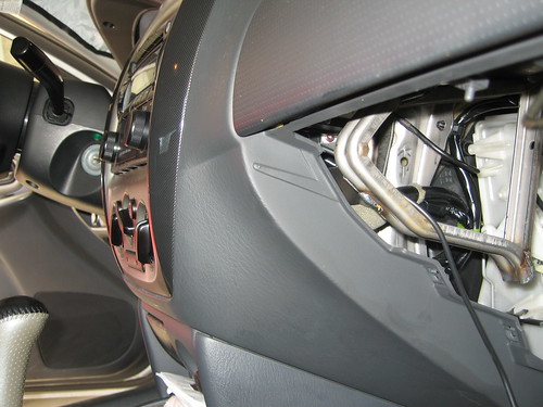

I really hate the way I mounted it (not at all really). It's just kind of dangling at the top of the glove box. I can't put it all the way in the glove box because the cable is too short. I need to find a location to mount it. I'm thinking I need to remove the glove box to get access to something to mount it to. Is that pretty straightforward? After fighting the OEM radio for an hour to remove it I'm a little hesitant to go ripping out my glove box.

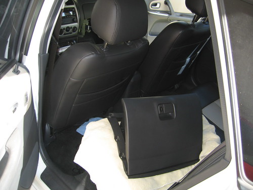

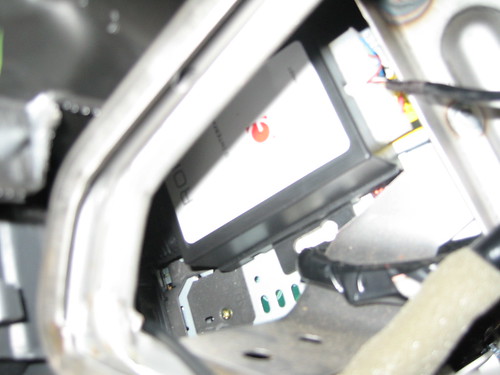

I've got the GROM device installed and working beautifully now. The glove box is a cinch to remove. Just unscrew 10 screws and pop it out. I affixed the GROM to the side of the head unit with sticky velcro. The iPod cable is routed through the glove box. So far I'm very pleased.
Here are a few install pictures:

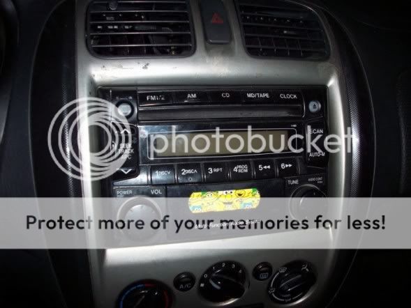

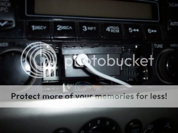

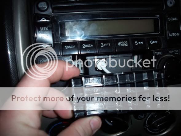

i actualyl pulled the radi and mounted the grom in the emopty space where the tape deck is and put it so i can change the cable to audio by removng the cover on the radio. and its routed threw the glove box.
if i rmemeber ill take them tonight when i get home.
i was going to take pics of me doing ti for the install but jsut kinda did it and forgot to grab the camera.

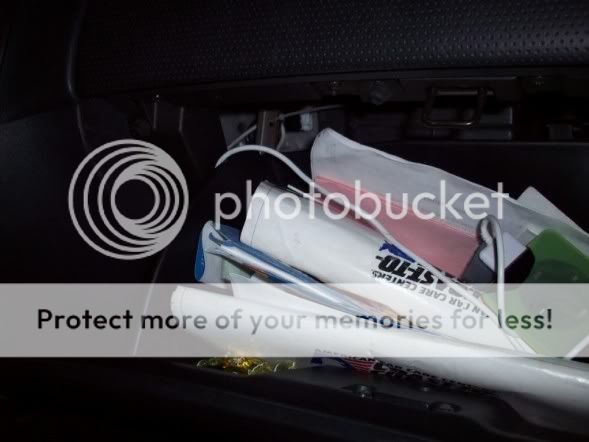

ok here you go......
I keep the ipodi n the glove compartment adn you cant see it at all
I hooked the grom up to the space where the cassette would be.
the way i put this it allowed me to easilly chagne the wire to hook up to my xm or otehr device if i ever choose too
