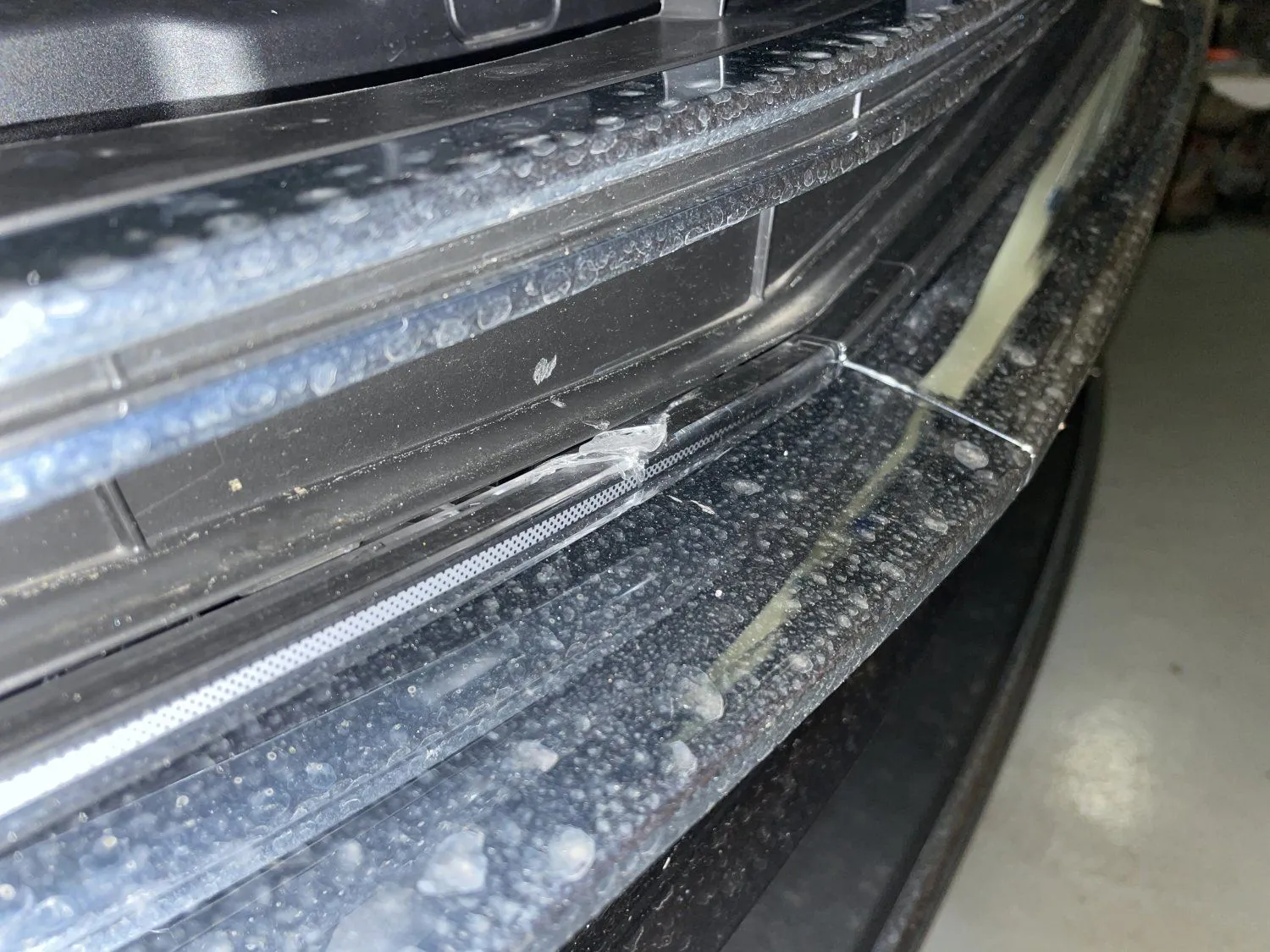

Received package with grill l(with led lighting) from CX-9 Signature (TK50-50-710G). During installation to my 2019 CX-9 GT, I did not find where to connect the grill wiring.
Does anyone know how to connect the Signature grill to GT? Is necessary wiring preinstalled in the CX-9 GT?

I don't have the answer to your question but hopefully this picture might help. The power source is routed to the fog light area.
You can see a pigtail from the grill is plugged to a white box. Then it goes down to the fog lamp. And this is the same on left and right side
