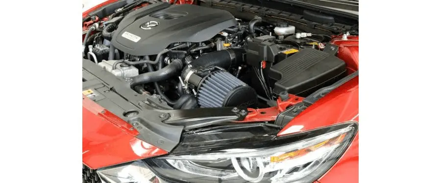

These are the two that i have seen...so far.
Basically the same except the K & N uses an aluminum tube and has an actual "air box".
Those are both "short ram intakes". A cold air intake, at least in the traditional sense, has a longer tube that extends further from the engine bay (usually down to the bumper where the ambient air is slightly cooler).
According to Unobtanium's communications with CorkSport (he installed the intake on his CX-5 GT Reserve), they determined that the "air box" was not necessary and provided no measurable benefit. Without a dyno graph from K&N to compare with, I guess we'll never know.
The K&N does reuse the OEM fresh air scoop, but it doesn't matter since the "box" isn't fully sealed. If it were, the intake would be pulling all of the air from the scoop, which pulls the air that flows over the radiator (just like the way the OEM airbox works). That's what I would like to see made, as that is, for all intents and purposes, a cold air intake.
