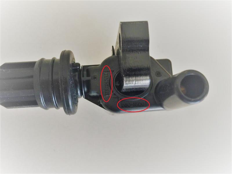

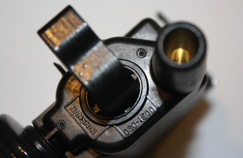

I purchased brand new ignition coils from Mazda here in Australia about 3 years back, and it has "HANSH/N" and "DSC-1500" embossed near where the ignition cord plugs into it. The coils I replaced also had the same embossing, and I know the full history of the car since new, which was always serviced at a Mazda dealership. Have seen some coils that have DSC-1500 printed on them, but I'm lead to believe they're not the same/genuine Mazda.
I don't know what brand they are, and Mazda could not tell me either. It has no brand name such as Hitachi or NGK anywhere on them. The old set I replaced had done over 80'000 kilometres (just under 50'000 miles) on them, and were still fine. I replaced them as a precaution.
A quick Google of 'HANSH/N ignition coil' gives me results that also leads be to believe they're genuine Mazda.

I can now confirm the photo I posted above is of a genuine Mazda coil. See photos below.
If it has 'HANSH/N + DSC-1500' embossed on the coil, it is genuine Mazda.
