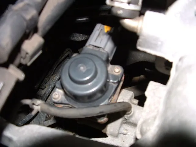

You are the best. I think I located the EGR but I'm still not 100% sure. I have the Protege 2000 DX so my location looks totally different from pics I've seen on here. Mine is a black cap with 4 Phillips Head Screws. My Location is right underneath Drivers Side closest to Steering Wheel.
So your saying all I have to do is remove the screws and take the top off and spray with cleaner ? The pictures & description I've seen in the "How To Clean EGR" thread on here, are taking a whole other piece out. If you could provide pics, that would be great. btw, my email is orlando22@bellsouth.net

Engine Light Came back on today after hitting the 60 MPH speed. EGR must be stuck open but I don't know where or how to look for where the problem is without having to take apart the entire EGR valve assembly.
patsfan4life said:
all you need to do is take off the intake from the throttle body, and right before the butterfly valve (throttle) there is an opening that leading into the EGR valve, when you get the intake cleaner from the car store it comes with a red straw for precise accuracy. just stick it into that opening give it a couple sprays, wait a few min, do it again, and ur set. i'll provide some pics tomorrow of the process if you'd like. its a 5min deal. im amazed how well it worked without taking anything apart.
here's a pic of what I think it is.
