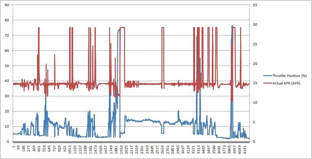

What's the accurate range of the onboard oxygen sensor? I think something is up with my Cobb AP readout- the data log shows multiple times where my AFR is as high as "29.25".
Seconds (sec) RPM (RPM) Knock Retard () Throttle Position (%) Vehicle Speed (mph) Actual AFR (AFR) Boost (PSI) Spark Adv. ()
75.34 2294 0 3.9 27.96 29.25 -11.75 10
Normally I thought AFR ranges were limited to as low as 9.0 (some sensors) to as high as 17-20.0 (some sensors).
Is this a fluke or a real number?

your fine. the injectors close during overrun, so no fuel is injected, hence, afr goes to infinity, but the scale ends at 30

I understand how that works, what I'm saying is I don't understand how it would show a 29.25. Is the range on the OEM sensor that large? Every aftermarket sensor and so on only makes a distinction between 10.0:1 to 17.0:1. That's what I'm referring to. I know that off the throttle fuel cuts out... does anyone know the real range of the sensor? (How rich and lean it can sense?)
See the attachment:

So apparently with the DISI, the AFR sensor is just extremely sensitive... I gather

yes the sensor is extremely sensitive, it has to be with DI since the car is running on the brink of knock all the time
1) The AFR reading is derived from a standard "OBD" PID for equivalence ratio (lambda).
2) A lambda value of 1.00 = stoich (14.64:1 AFR).
3) According to the OBD spec, the ECU gives a 16 bit value (0~65535) for lambda. which corresponds to a lambda value of 0~1.999.
4) When the injectors are shut off, the ECU will report that the lambda is 1.999 (the maximum value), when in fact it is infinity.
5) 14.64 * 1.999 = 29.26
