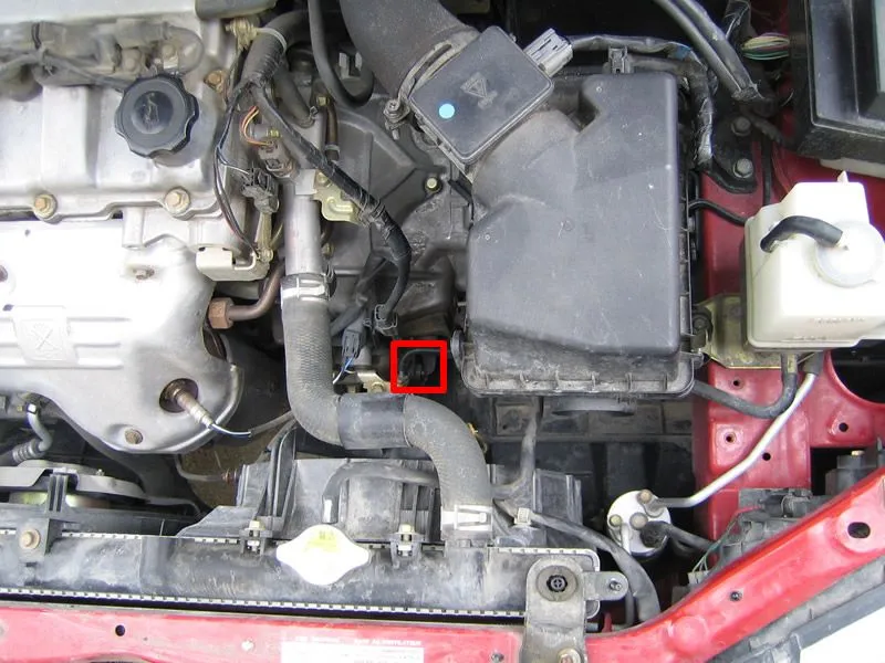

I have the same problem....i thought it was the release bearing but i'll try the grease fix first. It doesn't usually start until i've been driving for a bit and it gets warmed
Grease where the pin goes into the fork . My pedal is nice and tender but when it gets warm and release the clutch its feels wierd , it sutter at a certain point . I think it's the slave cylinder pin that gets worn out and cause that . Also the squeak can be from the fork inside the tranny .
But try this first it will help for sure
NOS, so what part of the engine is this... can you get a pic thats wider so I can see more of the engine? Thanks.
Tedster said:
And also NOS, what kinda car is that engine pic of? Thanks.
It's in the middle of the engine bay on the front side (side opposite of the firewall). You can see the front engine mount toward the bottom of this pic.
I can try to get a better pic for you. This picture looks exactly like my Protege5.
is this the same spot for the msp's??? i have the same problem. it getting annoying.
I'm not really sure but since the transmissions and engines are pretty much the same, I you could try looking around the same spot.
