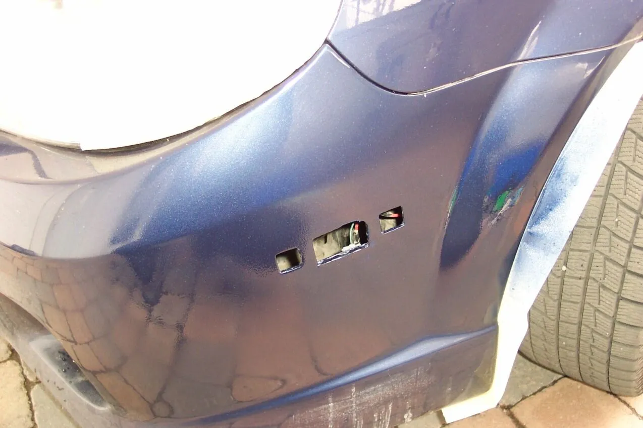

I sanded the excess Bondo untill it looked like the last pic above, then painted with color-matched spray paint. That's it for now..... Gonna wait a day or 2 to let paint dry before sanding and polishing.... Keep you posted.
Forgot I took pics while painting. Here's what it looks like after a few light coats of spray-paint....

Yeah, but I MUCH prefer these clear markers and they already cost me $37 US for these. No way I was gonna buy another set. Besides, no matter what I'd buy, if they don't have the exact shape and mounting method as the stock lights, I'd still see a heavy outline around the lights. If your bumper has never been painted, less work for you. I'm a professional model-maker, so I enjoy these types of projects... Just wish the weather would cooperate!

yeah, I actually thought about removing them completely, but I just spent $$ on these. I have a "look" in mind I wanna see through :) As for the compound, it wouldn't have worked. The step is really noticeable and even more so on the passenger side. In any case, if I want to fill the gap *which I do, then I'd have no choice but to paint anyway.

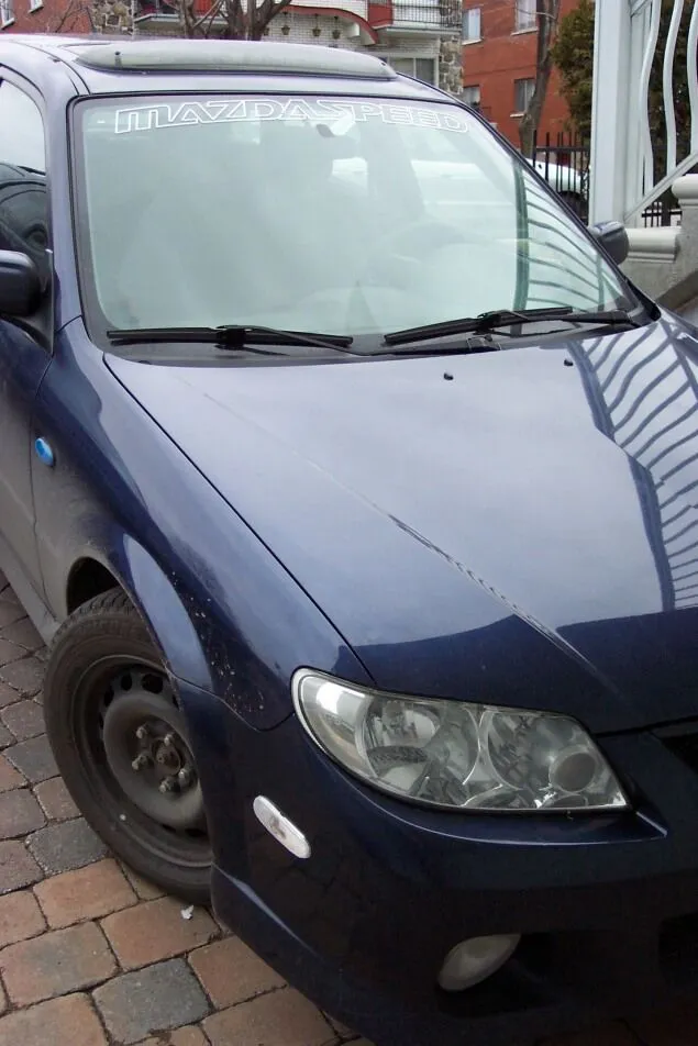

Well, i installed the lights. Here's the end result. No more gaps. No more paint outline of where the old marker was. The only thing that's left for me to do is wet-sand the paint with 1000-2000 grit, then polish. Good as new.
