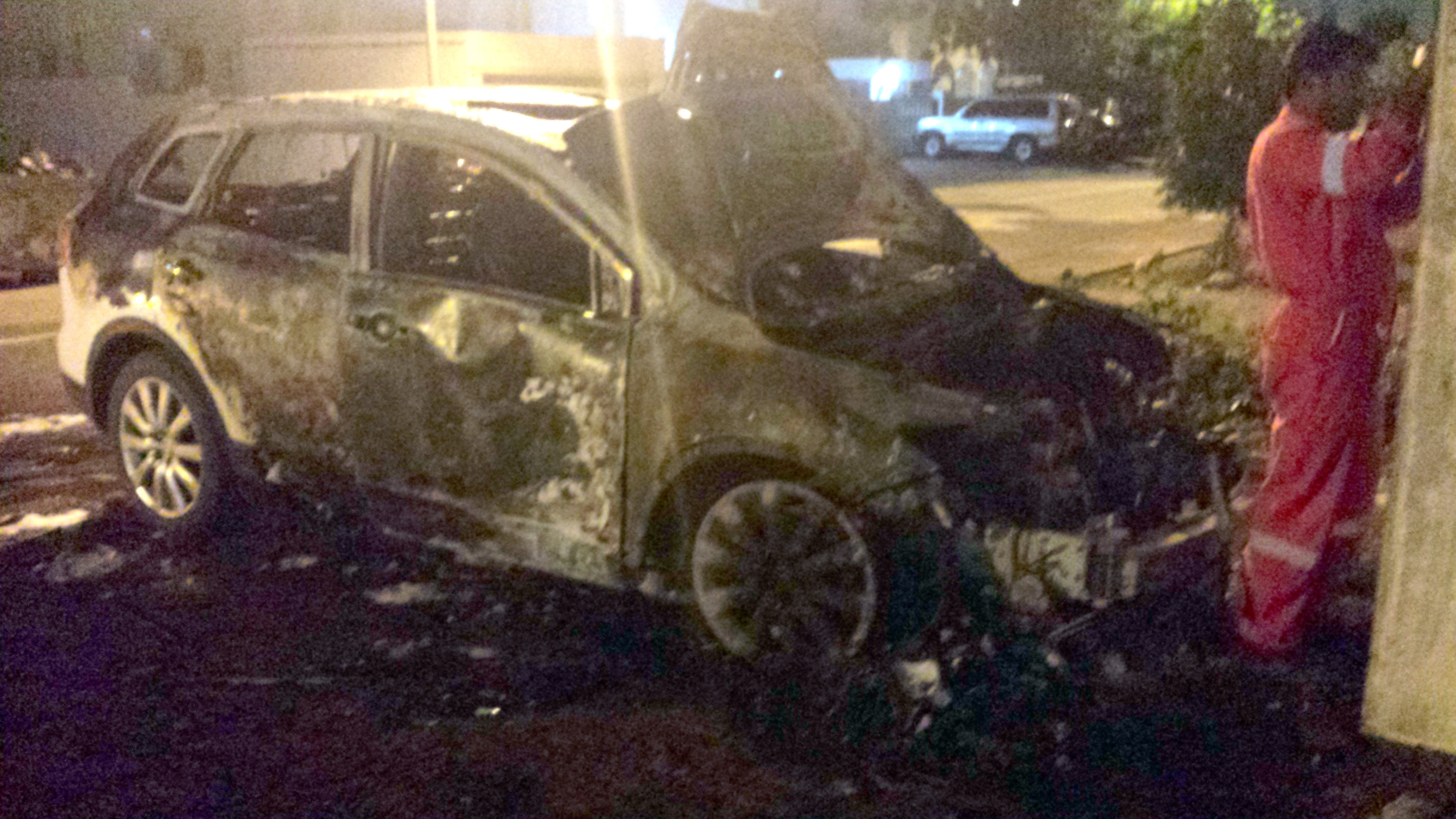

Google CX-9 transfer case fire, there's been two documented cases, one in front of a woman's house with kids, thank god the kids got out and another time a guy smelled something burning and didn;t even know his car was on fire underneath, he pulled into a gas station and gas attendants started spraying the fire with fire extinguishers, it's all online, this is a disaster waiting to happen, Mazda will be in deep crap if god forbid someone dies because of this, they have known this issues for years from 2007-2015 and did nothing, I'm getting rid of my 2013 CX-9 AWD this summer for something safer. Sludge typically occurs around the 35,000 to 40,000 mile mark, right when bumper to bumper warranty runs out, at that time after a long drive, owner might start smelling burning oil and see some oil dripping by center front axle area. Only way to prevent this is to change out the inferior OEM oil and service it regularly (~every 15K miles) but most typical owners don't know about this problem unless they somehow find this forum or search for Youtube videos on CX-9 transfer case. Dealers just play stupid and say it's a sealed unit, it can't be serviced because there's no drain plug. But they know it's a problem and change out transfer cases on a regular basis, it's a cash cow for them, typical cost to fix is like $2500-$3000. All Mazda did was extend the transfer case warranty to 90,000 miles but if transmission splines is damaged, it doesn't cover the cost of a new transmission.
