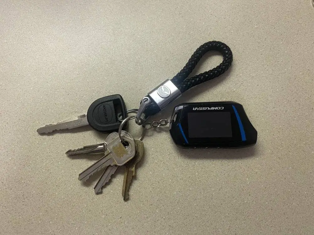

I got rid of my smart-key, had two chip keys cut and programmed for $150CDN.

A chip key is a key with a computer chip in it that is programmed to your vehicle allowing it to start. Most vehicles have had these since the mid 90's.
I stay clear of dealers; they told me I couldn't do what I did, and tried to get me to spend $100's more to do things their way.
Okay so with that you still need to remove the plastic cover from the key slot and actually use the key itself to start the car?
