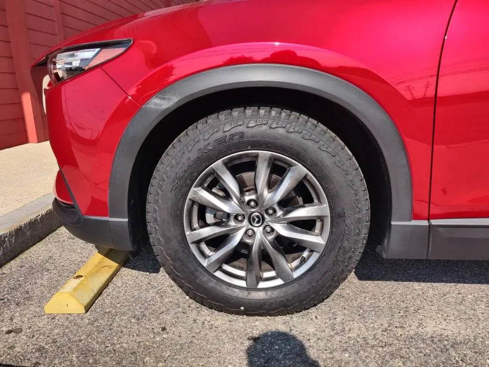

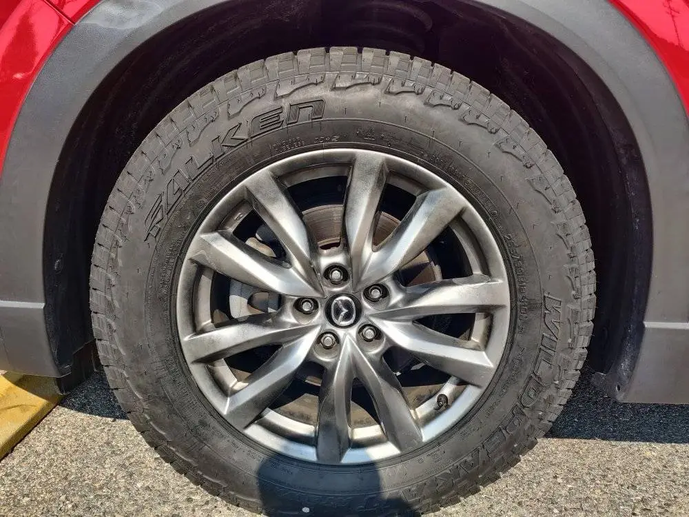

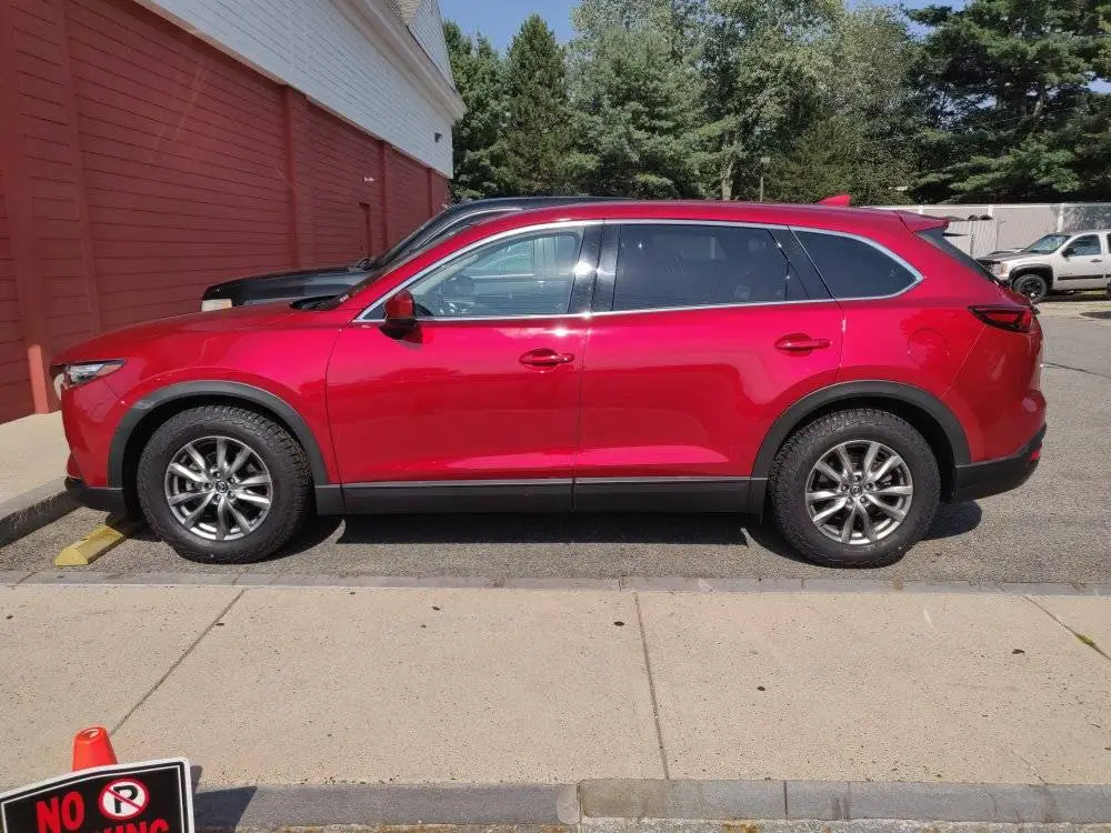

Swapped my OEM yokos to Falken Wild Peak AT/3w in 265/60r18 setting, got 4 wheel alignment done as well too. Off the bat, the steering felt a little lighter, not a huge difference in acceleration or mileage, I guess the tire noise is low too. These are initial impressions ~30mile return commute.
I was not sure if the off road type tires would look out of place on my cx9, but I don't find it awkward/loud.
The car however seems to pull to the left at higher speeds (>60 mph) Im sure this wasn't the case before the alignment today. Will test it out a bit more this weekend and will take it in if the car continues to pull left.
