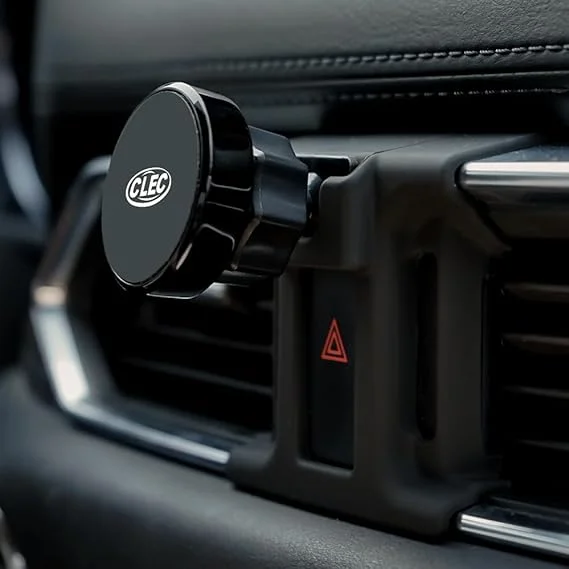

No not really since I want the cable out of sight as much as possible and I don't want it sticking out from under the lid of the console box. Here is a photo of the phone mount I ordered, so when the phone is attached, the USB port will be facing down towards that tray and I'd like the cable to enter through a hole I drill in the tray then plug into the phone which should be only a few inches away. The phone holder is supposed to be delivered today, so maybe I'll take a few photos to post later.
I've got the same clip to the vents, just the phone attaching part is different. Can't think of a better clip for a CX-5.
I had a magnetic mount for my 2020 C8, via cupholder and it worked okay. Since I already the metal attachment disk on the back cover of my phone, I decided to go with another magnetic type mount. This one looked nice so that's why I ordered it. It's nice to know that someone else with a CX-5 is happy with it, as I'm sure I will be happy with it too.
