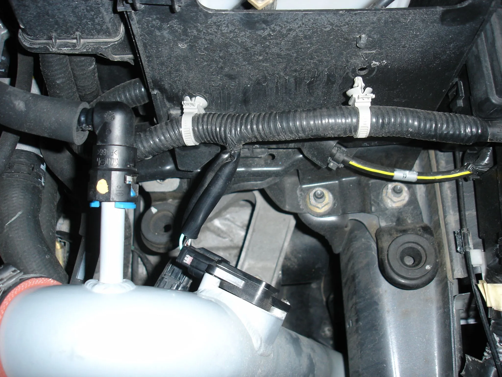

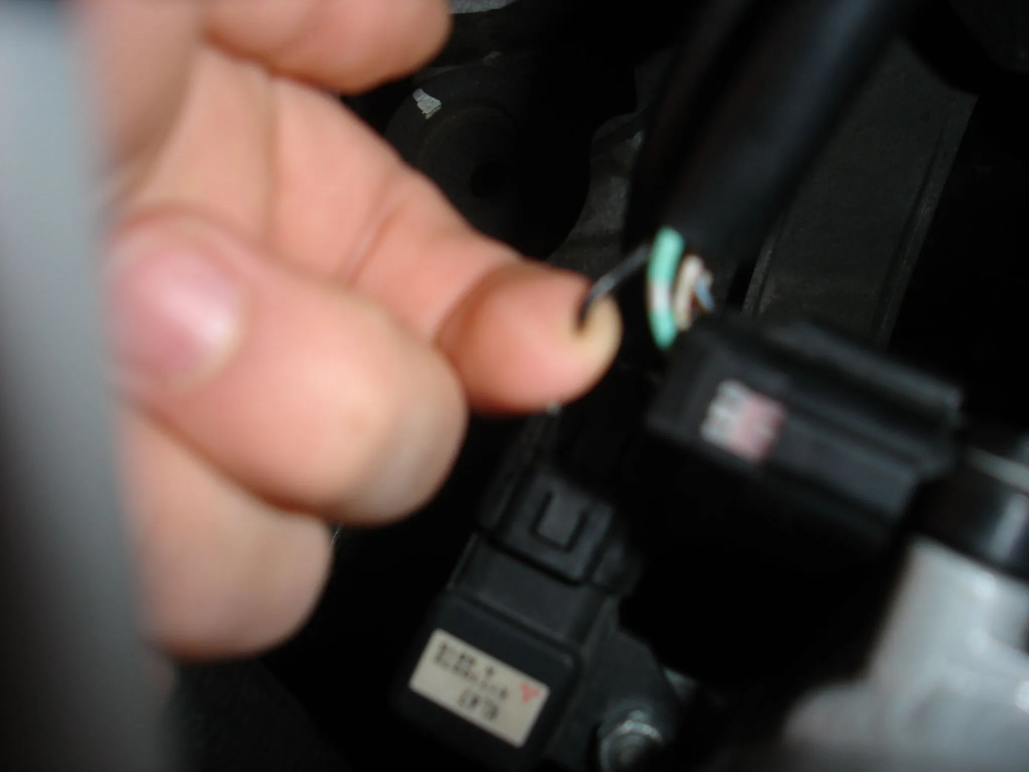

I found my problem. The reason it didnt make the enging choke when i jiggled the wires around is because one of them is completely disconnected. The first picture is of the setup in general. The second is of the detached wire. Anyone know if a dealership would be able to sodder this back together or is this to the point where i need a new MAF.

DANG that sux thats the first time ive herd of them comming completly loose. I guess you could get it soldered or sumthing. Good job on finding that and good luck with the fix.
i MIGHT have the plug that plugs into the MAF sensor, if so ill send it to you with like 5-6" of wire and that way you can just solder them back together. You might be able to find the little pins that go into the plug too.
Yeah, a new MAF won'r get you a new wire harness. It will have to be repaired.
I've seen this problem reported on other boards as well. It happened to me. Seems the wires are not very secure and after about 6 - 8 months after instalation of an aftermarket intake(I have the Simota), they work themselves loose.
