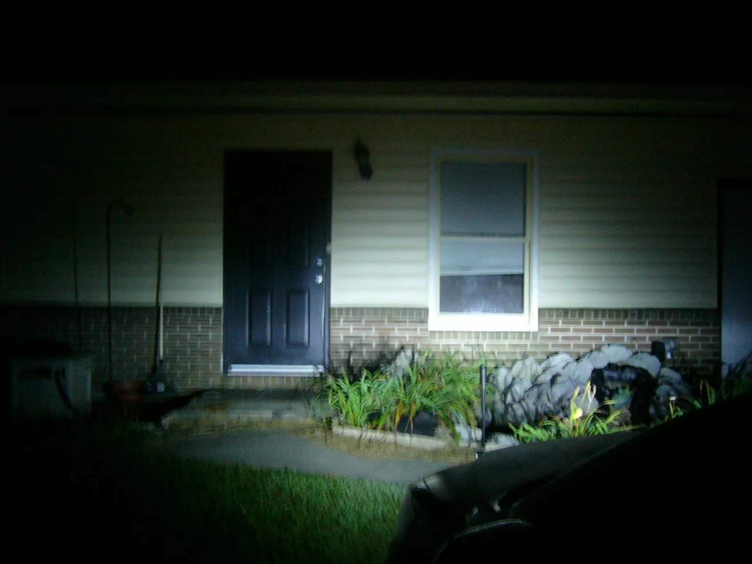

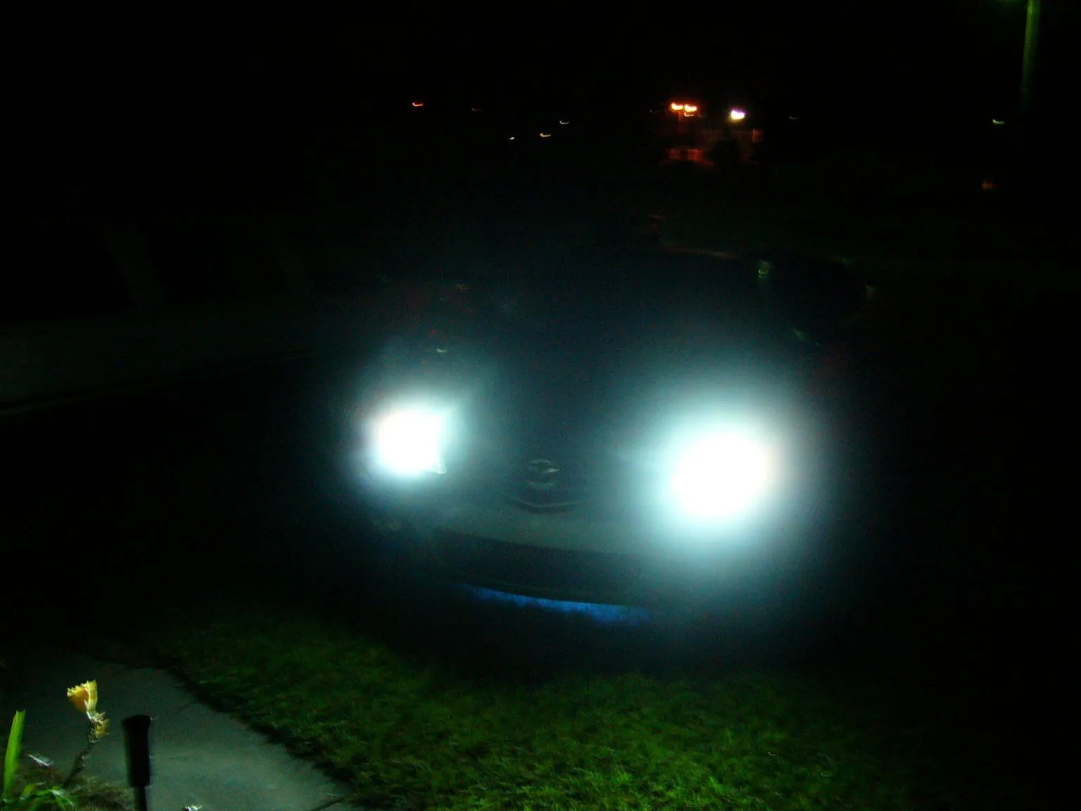

I'll take a couple more tomorrow to show the cutoff on a better surface.

From the side of your house it doesn't look like there's any cutoff at all
looks like there's alot of excess glare and no cutoff. take a pic against a wall or garage. make sure your car is perpendicular.
Better pictures of the cutoff
It looks bad because the yard has a pretty good slope to it.

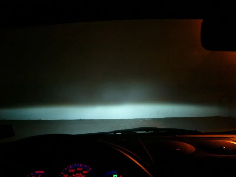

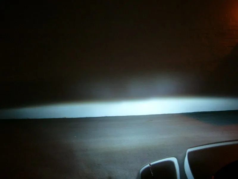

here's some pics on flat ground.

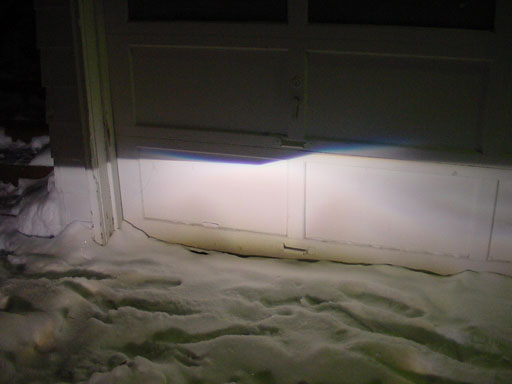

There should be a distinct line where the light ends, and above that there should be no stray light. You can see the difference between the picture I posted and the one above it... there's stray light above the line.
In a D2R setup (versus D2S) you won't get as soft of a cutoff, but you will see some definition. Obviously, the only way to achieve a true cutoff line is with Projector beam type lenses...
I'm not sure what D2R and D2S are... is that just the difference between projector and reflected beams?
D2R is meant for a reflector type headlight HID, and D2S or D1S is meant for a projector beam headlight, in short.
